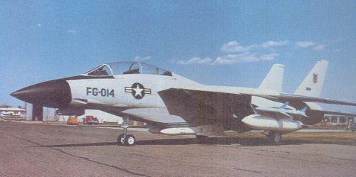

The naval F-15 was partially in reaction to the proposed F-14 (ADC) USAF interceptor, of which there was no chance of USAF buying. The navalised F-15 didn't go very far because it would have cost more to do than continuing the F-14, and probably wouldn't have performed as well.
It's intersting to note that on the F-14 (ADC) the conformal fuel tanks are gone and that the wing root pylons were now "wet". I can't remember if the belly extension carried fuel as well.
