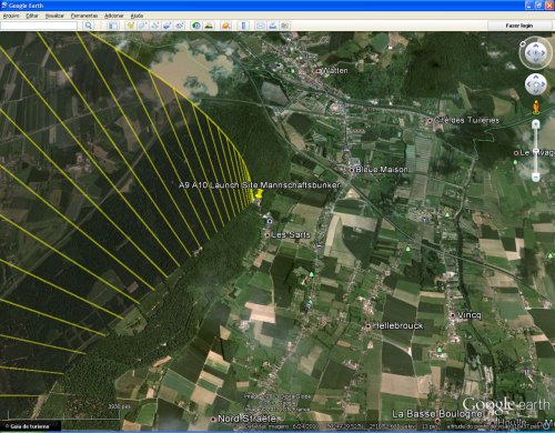

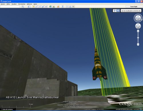

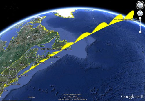

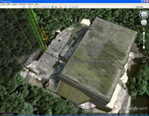

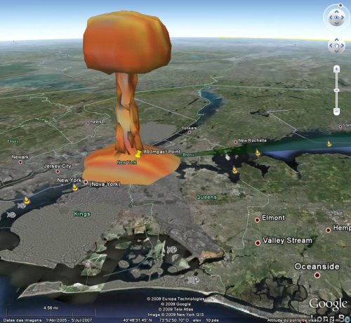

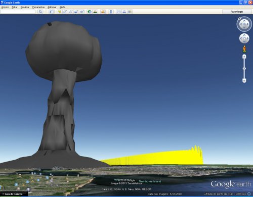

My simulations show that the flight would be possible. Probably the materials of the time would not support the dynamic pressures and temperatures.
In my simulation, the launch of the bunker was located in France and New York target.
Ballistic trajectory is drawn in yellow. My software (simulation of launch vehicles) produces the trajectory charts directly in Google Earth.

Could this software be modified to show examples of a full nuclear exchange during the Cold War (using known target lists, battery locations and CEP of ballistic missiles)?
It is one thing to know that there were at least three missiles aimed at a target and what their CEP was - it is another thing to actually see examples of what a particular delivery would look like.

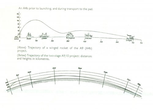

In principle the A9/A10 combination would be launched in ballistic-like trajectory quite similiar to the A4's one, only longer.
After the A10 separation the A9 (or A4-b it depends by the sources) would take a very long supersonic glide.
Some author (like Kenneth Gatland) reports of skips like the Sanger Silbervogel but it is unclear if it was only a guess or there was some reference material around it.
[/quote
In the early postwar years there seemed to have been a lot of confusion and conflation regarding the Sanger and A-10. Combine wartime/postwar confusion with partial data, misheard rumors, intentional disinformation and just flat-out amazement and disbelief over the sci-fi nature of things, it's not surprising that the skip trajectory of one exoatmospheric weapons system was mapped onto the gliding trajectory of another exoatmospheric weapons system.

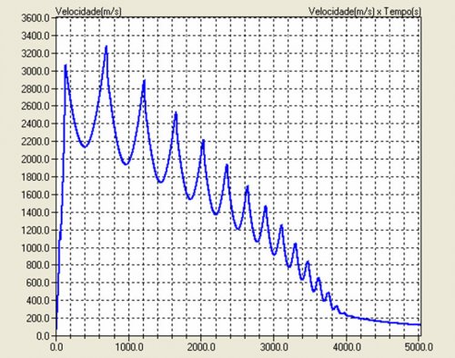

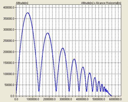

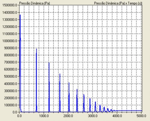

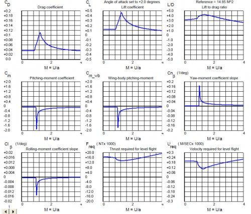

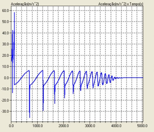

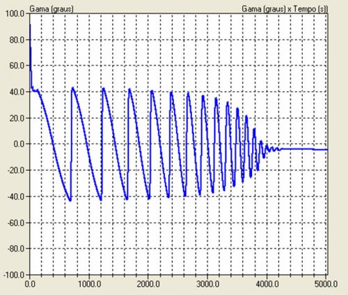

The simulation shows a trajectory similar to Silverbird.

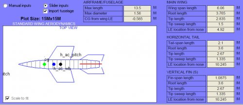

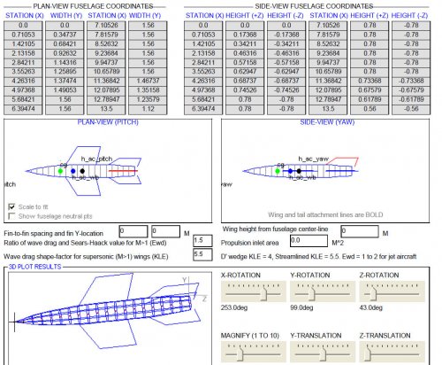

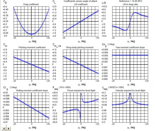

Follow the A9 some aerodynamic data used in the simulation that follows also some graphics.
It was very interesting result.
Miraglia
www.edgeofspace.org

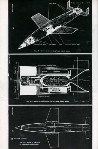

In Popular Science out. 1947
Miraglia
www.edgeofspace.org

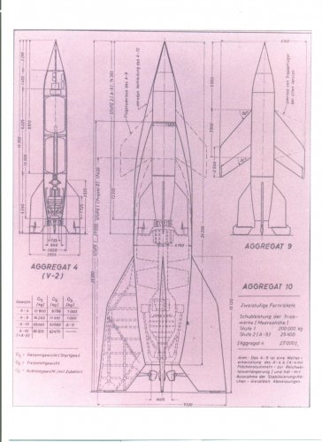

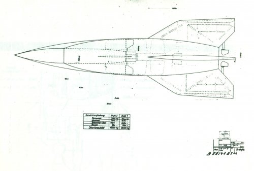

Hi
some wartime stuff here... :)
