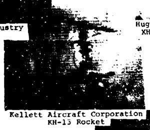

Allow me to add to the Kellett mysteries with this mention of a Kellett KH-13 Rocket (along with a picture that is undecipherable).
Source: http://www.dtic.mil/cgi-bin/GetTRDoc?Location=U2&doc=GetTRDoc.pdf&AD=ADA108091
The same designation is found elsewhere for the "Stable Mable" (although other sources give the latter as the KH-15): http://www.helicopteros.com.br/hist10.asp

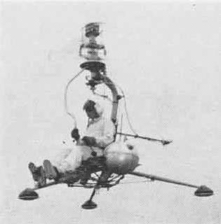

KH-15 1954 = USN. 1pOH propelled by small hydrogen-peroxide rockets at the rotor tips; ff: 5/13/54. POP: 1 for testing by the Office of Naval Research [140957].
A KH-15 is also enclosed.
Thanks Jos. Despite the more than lousy quality of the image, the KH-13 Rocket also appears to feature counter-rotating tip-jet rotors, like the KH-15, and may therefore have been a prototype for it.

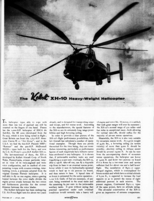

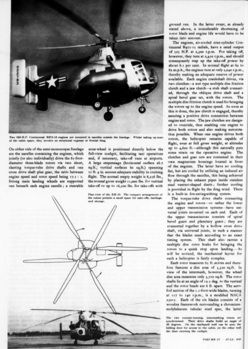

Anyone know of drawings for the Kellett XH-10 Synchropter? Looks interesting!
Enjoy the Day! Mark
  • History of Kellett - FKMeek.pdf

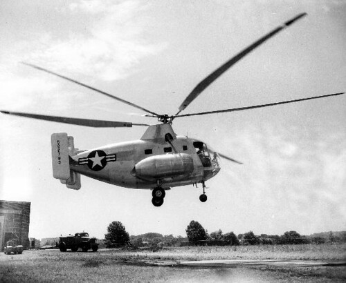

Drawings, no. But photos you'll find a few on the web if you search for "Kellett XR-10" instead of the later "XH-10" redesignation which was not used for very long. You can also find the earlier XR-8 Synchropter, which greatly influenced the design of the XR-10 (dubbed the Eggbeater).
Here are a few links for you:
http://www.aviastar.org/helicopters_eng/kellett_xr-8.php
http://www.aviastar.org/helicopters_eng/kellett_xr-10.php
http://en.wikipedia.org/wiki/Kellett_XR-10
http://www.flickr.com/photos/sdasmarchives/4563936997/
http://www.flickr.com/photos/sdasmarchives/4563937005/
Production:
XR-8-KE: Kellett KH-1 Synchropter, one Franklin O-405-9 engine, one built [USAAF s/n 43-44714]
XR-8A-KE: Kellett KH-1 Synchropter, one Franklin O-405-9 engine, one built [USAAF s/n 44-21908]
XR-10-KE (XH-10): Kellett KH-2X-C "Eggbeater", two Pratt & Whitney R-985 Wasp Junior engines, two built [45-22793,22795]
Second XR-10 may never have been completed.
Production version was to be built by Hughes as the R-10A-HU (H-10A) but this was cancelled.

Mark: thanks for the JAHS article. Alas, no mention of that elusive KH-13.
Stéphane: elsewhere you mentioned that KH stood for Kellett Hughes. I'm wondering if it wasn't Kellett Helicopter -- in line with KD/Kellett Direct-control?
