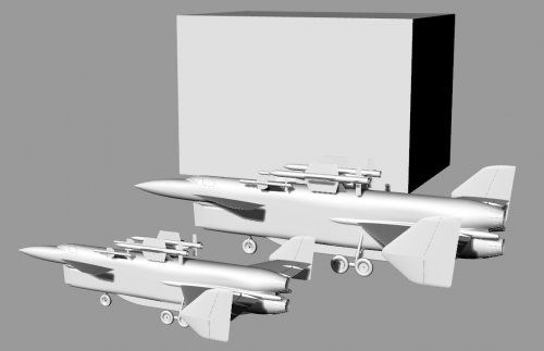

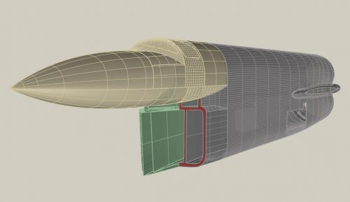

Third test bed is near to close. I'm surprised how much small errors is in my older models. For rendering it was not problem but now I have to do only closed volumes. Next favorites are prepared

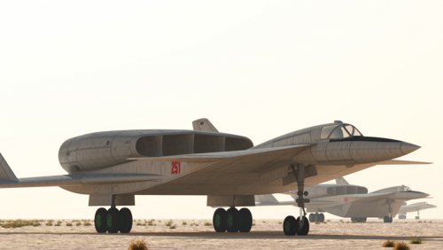

First "hot" 3D-model

Very beautiful model, is it the Vickers 559 ?

Of course, I like these heavy beauties (length 20.8 m and what about Northrop N-144 Lenght: 35,55 m - more as B-58B).

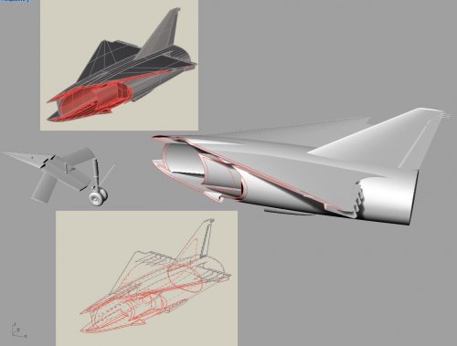

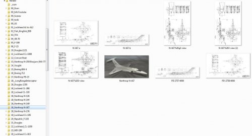

N-167 has already its own directory. N-176 is ready

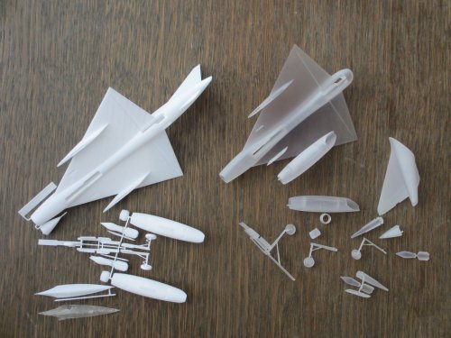

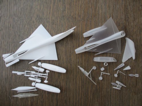

first 3D models are printed out. So lets go totally rebuild them

There are multiple things to change for easier handling in printing, which I want to be changed. For example multiple parts are smaller than support net in cleaning machines, adding some sprue to them would make my work as a printer a lot easier (and if there are multiple models printing at the same time it makes it easier to separate parts from different models). Another example is support material, while it is a bit cheaper than the actual matter cleaning it from small cavities is PITA and can easily add a day in production time (the whiteness in wings are example of some leftover support material).

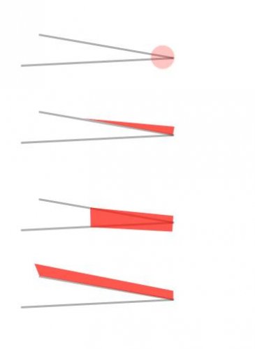

we suppose scales 1/72 and 1/48 and unique designs resp. all design family (Archangel, Fish, Kingfish. Vickers VA559, Avro 730 ). But I solve now problem with printing sharp edges on wings. When we will know all rules then it will be very fast

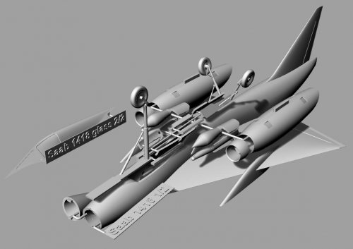

Last iteration of Saab 1418. Ready for printing

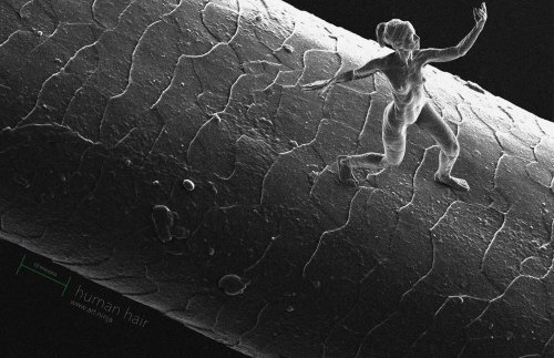

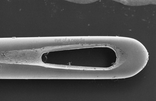

offtopic but pretty cool and beautiful. The "smallest creation of the human form in history" (oct. 2014) printed in 3d by artist Jonty Hurwitz. Amazing what this technique feature is able to make! Hmm will there be a nanoscale Myasishchev? Just kidding... ;D
