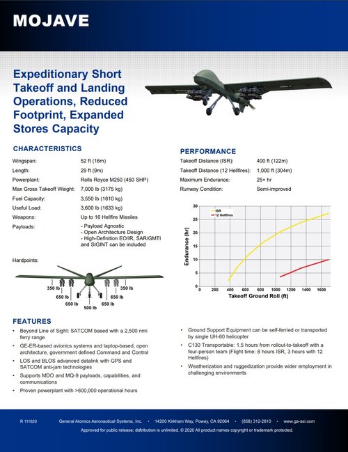

Mojave is based on the avionics and flight control systems of MQ-9 Reaper and MQ-1C Gray Eagle-ER but is focused on short-takeoff and landing (STOL) capabilities and increased firepower. It features enlarged wings with high-lift devices, and a 450-HP turboprop engine.
Mojave provides options for forward-basing operations without the need for typical airport runways or infrastructure.
Payload capacity is 3,600 lb. (1,633 kg) and Mojave can carry up to 16 Hellfire or equivalent missiles. Mojave can be equipped with a sensor suite including Electro-optical/Infrared (EO/IR), Synthetic Aperture Radar/Ground Moving Target Indicator (SAR/GMTI) and Signal Intelligence (SIGINT) to support land or maritime missions.

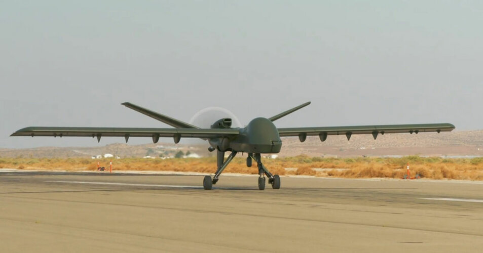

This looks very useful. STOL, probably carrier capable, up to 16 Hellfire type weapons and I think I saw a 25 hour endurance mentioned.

Not sure about "carrier compatible". The video says 1200 ft take-off roll and 1500 ft landing roll. That's longer than a carrier.
You are probably not factoring wind.
Even with significant WOD, this would be carrier compatible only in the same sense as the OV-10 was. Meaning only with the flight deck cleared and for special circumstances like ferry operations. True carrier compatibility, for the USN anyway, means cat and trap capable, not just being able to fly off or recover using the whole length of the flight deck. That interferes with regular flight deck and hangar ops far too much to be tolerated.
