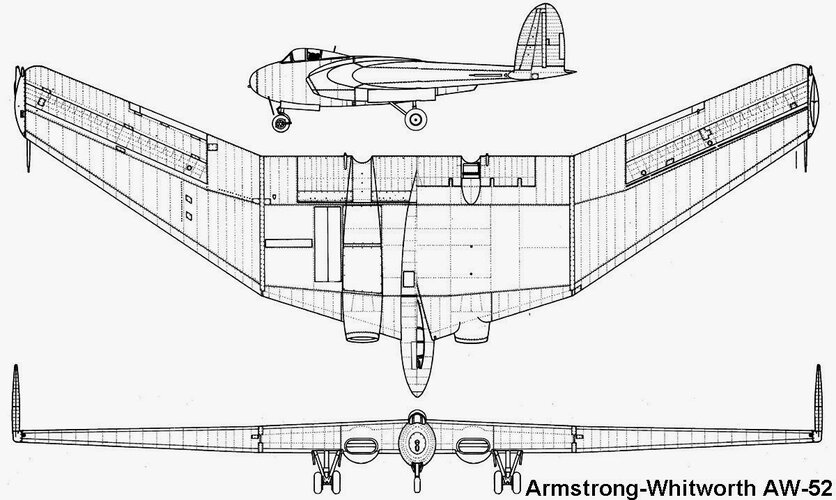

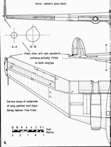

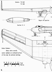

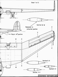

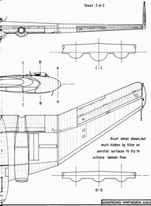

anyone know where i could get a decent accurate plan for this plane?
me and my mate have been talking about making a rc ducted fan model of this plane.
I once found this drawing in the net, sorry,correct source unknown, my description file
is empty ( a problem, I stumbled across by one of the ACDSee updates .. ???) ! So I
just post 300dpi files here, if it is, what you need, just send me your mail adress via PM

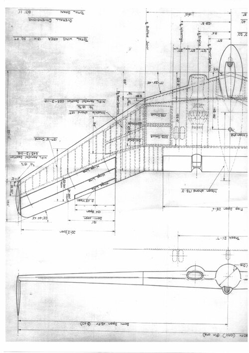

don't know where you've got them from, but they've been pinched from 'British Experimental Jet Aircraft' by barrie hygate, pp. 36-39. :mad:
cheers,
Robin.
Sorry, as I've mentioned, I haven't the url anymore, but the drawing
was (or is ?) downloadable as "aw52.zip", as I've still this file and IIRC,
I got there via a link from another site. :-[

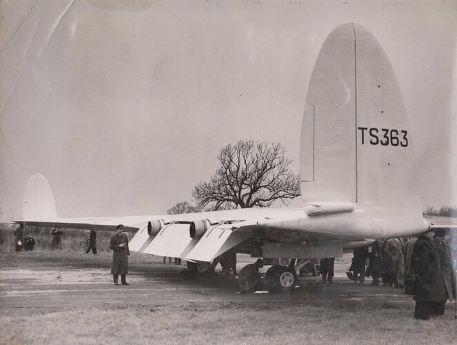

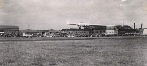

Here is a beautiful photo of the A.W.52 prototype (TS363) at the SBAC show at Farnborough, 1948.
RAeS Library photo

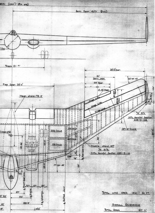

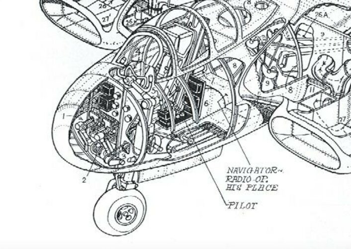

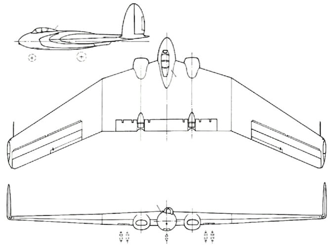

Hi! Which drawing is correct?

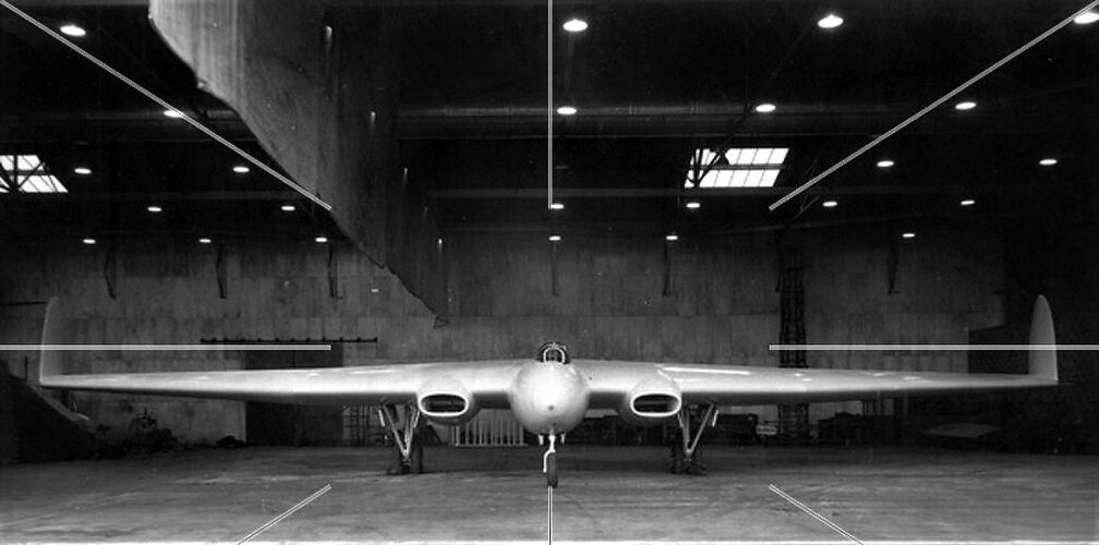

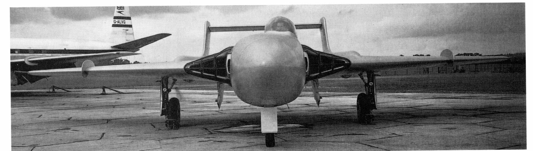

According to "BRITISH EXPERIMENTAL JET AIRCRAFT , BARRIE HYGATE", cockpit was offset 3" to the left of the centerline.
That is correct, the offset is quite clear in front-view photographs. Which means that your first attachment is inaccurate for at least the cockpit, a warning that drawings which include a lot of detail, such things as panel lines and rivets, are not necessarily right.

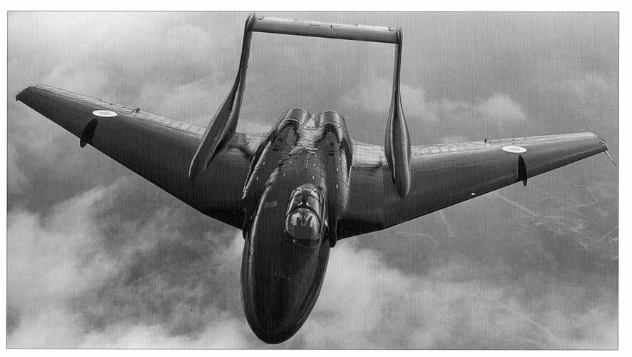

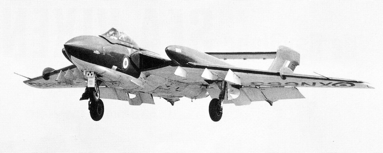

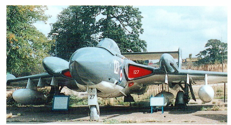

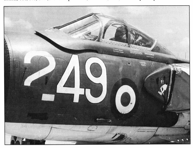

To give space for the navigator/radio operator. A similar solution was used for the DH Sea Vixen

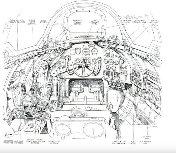

From Justo's posts 11 and 12, the drawings show that the navigator is located behind the pilot and there is no space beside the pilot. I am asking what the reason for the offset is in this case.
The left side of the cockpit is dominated by controls and the right by instruments and that may be part of the reason.

Good question and good answer!
The goal was to improve visibility down during landing
