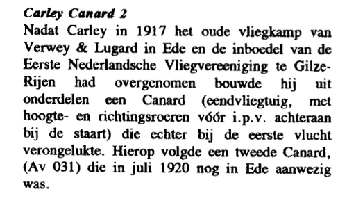

There are huge gaps in the Carley designation list. The two 'Enten' canard aircraft constructed around 1917 don't appear to have been assigned designations at all. So, Carley's designations begin with the Carley S.1. In this case, the prefix letter is for designer Theo Slot. This is followed by Carley's own L.II (or L-II) design. Note the shift from Arabic to Roman numerals.
[Added] An unbuilt design from Ede was the 16-passenger, twin-engined, monoplane airliner designated V.1. With little to nothing to back it up, I have speculated that the 'V' in the designation may be for verkeersvliegtuig or 'commercial airplane'.
There is no sign of unbuilt Carley projects between the C.III trainer and the C.12 light aircraft. Again, note the change in numeral style (this time, from from Roman back to Arabic). I am not aware of any numerical designation for Carley's Werkspoor Jumbo.
And what of the Carley Baby? Some sources list the Baby as the Carley 'C2' but the C.II was a biplane. Was the Carley Baby the same as the S.1? Or was it actually the C.12? Or is the Baby a completely separate Carley design only conceptually connected with the others? Can anyone help with this?

Carley Canard - 1917 flying school canard aircraft trainer, x 2
-- 1917 Canard: Single-bay biplane, pylon-mounted upper wing
-- http://www.earlyaeroplanes.com/br.challenge/aircraft/ersatz/854_Joop.Carley.Canard.no.2-1917.jpg

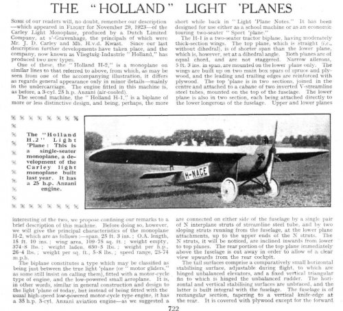

Carley C.12 - 1923 single-seat shoulder-winged monoplane
- C.12: aka 'vliegfiets', 3-longeron fuselage, span 7.50 m
-- C.12 had 1 x 10 hp, 74 cid, Indian Chief air-cooled V-2
- C.12 : Re-eng. 16 hp Sergant A air-cooled upright L-4
-- Sole C.12, H-NACB, suffered accident, reg. cancelled
- C.12a: Oct 1923, re-eng. 20 hp Anzani 3-cyl inverted-Y
-- C.12a reg. H-NACI [due to major component replacement?]
-- 3V http://aviadejavu.ru/Images6/FT/FT1923/11/727-2.jpg
-- NB: Flight 3-view config. before faired headrest fitted
-- http://www.nederlandseluchtvaart.nl/forums/showthread.php?t=34019

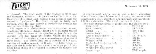

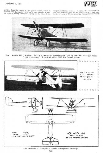

Holland H.1 - 1923 2-seat biplane (part designed by Carley)
- H.1: Tandem seat, 35 hp Anzani 3-cyl, span 8.00 m*
-- * Lower wings had longer span, Warren truss bracing
-- http://neon.pictura-hosting.nl/sfa/sfa_mrx_bld/thumbs/500x500/upload/upload_669SFA022811919.jpg
Holland H.2: July 1924 C.12a devel., 1 x 25 hp Anzani
- H.2: Shallower, rounded fuselage; re-shaped fin
-- Holland H.2 aka 'Holland-kindje' (Holland Baby)
-- H.2 developed by Theo Slot and H. Van der Kwast, x 1
-- http://aviadejavu.ru/Site/Crafts/Craft33512.htm

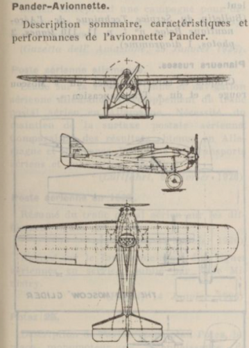

Pander D - 1924 Carley C.12a/VIH H-2 evol., x 11
- Pander D: Single-seat, shoulder-wing monoplane
- Pander D - 25 hp Anzani* inverted-Y engine, x 9
- Pander D: 1st prototype, first flew 16 Nov 1924
- Pander D: Prod'n, 2 x MLA, 2 x LA-KNIL (East Indies)
-- MLA Pander Ds P-1 & P-2; LA-KNIL Ds P-501 & P-502
-- * 1 x French-reg D re-eng with 45 hp Anzani

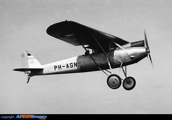

Pander P-2 - 1929 2-seat tandem parasol-wing sports a/c, x 1
- P-2: 1 x 100 hp DH Gipsy I, span 10.34 m, c/n 29, PH-AGN
-- http://www.airteamimages.com/pics/69/69953_800.jpg

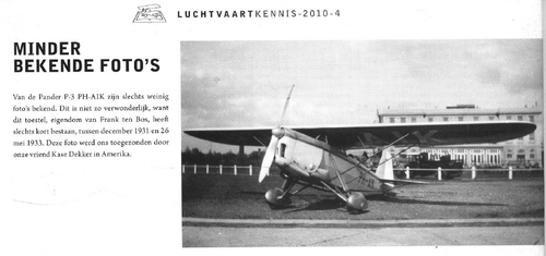

Pander P-3 - 1932 2-seat tandem parasol-wing sports a/c, x 1
- P-3: 1 x 120 hp DH Gipsy III, span 9.40 m, c/n 41, PH-AIK
-- Built for Mijnheer ten Bos (or 'ter Bos' or 'Ten Bosch')
-- P-3 later modified to have an enclosed cabin

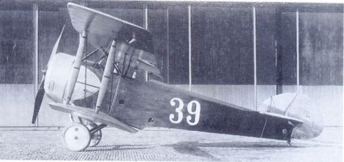

Spyker V.1 - 1916 single-seat biplane fighter, 1 x prototype
- V.1: 1 x 80 hp Thulin (le Rhône) rotary, streamlined cowling
-- Designed by HA Vannehard and AG von Baumhauer, w/o 1920
-- http://flyingmachines.ru/Site2/Crafts/Craft29127.htm

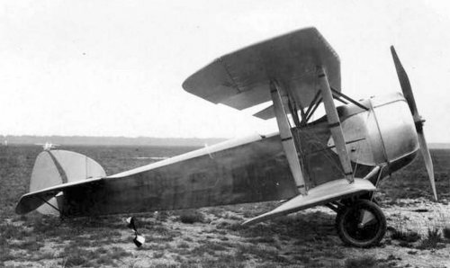

Pattist-Walraven PW-1 - 1933 2-seat mid-wing monoplane light a/c
- PW-1: Nov 1933, 1 x 85 hp 7-cyl Pobjoy R pusher, span [?? m]
- PW-1: LA-KNIL staff design by Walraven & Kapitein MP Pattist*
-- Flown 23 Nov 1933, c/n I-1, reg. PK-SAM, w/o Bandoeng 1935
-- http://www.flightglobal.com/pdfarchive/view/1934/1934%20-%200592.html
-- * Maurits Pieter Pattist, often misspelled as 'MV Pattist'

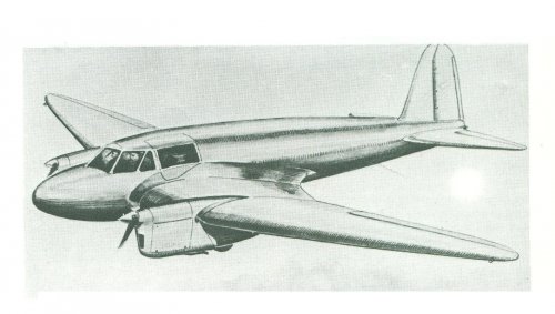

Walraven W.2 - 1934 low-winged twin-engined, 2-seat cabin a/c
- W.2: 2 x 90 hp 7-cyl Pobjoy Niagara, Span 11 m
-- W.2 c/n 2 PK-KKH, flown Jan 1935, destroyed Feb 1942
-- Wooden constr'n, spruce formers with plywood covering
-- W.2 prod'n planned, thwarted by accidental death of Khouw*
-- * Millionair W.2 owner, Khouw Khe Hien (aka Xu Qixing)
-- Het Nieuws van den Dag, 29 Jan 1935, pg10
-- http://resources2.kb.nl/010230000/pdf/DDD_010230315.pdf
-- https://www.flightglobal.com/pdfarchive/view/1935/1935%20-%200444.html

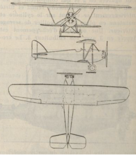

here is a two Pander aircraft 3-views.
http://gallica.bnf.fr/ark:/12148/bpt6k97675232.r=document%20aeronautique?rk=21459;2

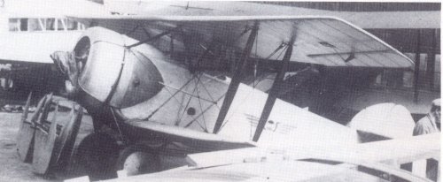

Who can tell me were comes the information fram that the Carley L-II/NVI C.II was a side by side trainer?
Needs good search.
The C-II had the seats behind each other and the C-III was a side by side
I cannot recall where that side-by-side ref came from ... and its entirely possible that I've garbled information on the C-III with the C-II :-[
Looking at photos on the NIMH website suggests either a tandem 2-seater - as you say - or, as in the case of the rear-view (link below), a single-seat (front cockpit only).
https://images.memorix.nl/nda/thumb/620x620/2d194d5e-f9e8-ef64-858c-b44e4a819e13.jpg
this something

1924 Vliegtuig Industrie Holland H.1 & H.2 Lightplanes (Carley company successor)
Source Flight International

Via a friend from Dutch forum,
and from Luchtvaartkennis 1996 06;
Carley Canard 2
After Carley in 1917 the old air camp of Verwey & Lugard in Ede and the contents of the
First Dutch Flying Association in Gilze-He built up rows parts a Canard (duck plane, with
height and direction cycles at the front instead of at the back at the tail), however, on the
first flight killed in an accident. This was followed by a second Canard, (Av 031) which is
still present in Ede in July 1920 used to be.
Need more Info,
Van Berkel Jager-I was a biplane fighter Project,powered by single engine ?.
Almost the source; De Nederlandse Vliegtuig Encyclopedie
Thanks hesham. So, it appears that Carley's canard was called Canard and not 'Ente'. The use of 'Ente' (in place of eend) did seem strange. Still, other German terms were in use in Dutch aviation at the time. It is possible that modern folks are editing out the Duitse ;)
