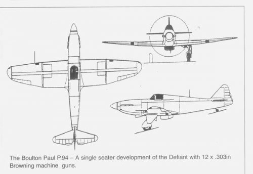

Thread to discuss the "sans turret" variant of the Boulton Paul Defiant, proposed in august 1940. 12 machine-guns in the wings :eek:, Merlin XX engine, 610 kph...
Is there three-views or pics of the plane ?
Oh, it's just a Defiant without turret ... ;D
(from Alec Brew, "Boulton Paul Aircraft""

A larger, heavier, draggier Hurricane II with 70kph speed advantage on the same power? I don't think so somehow.

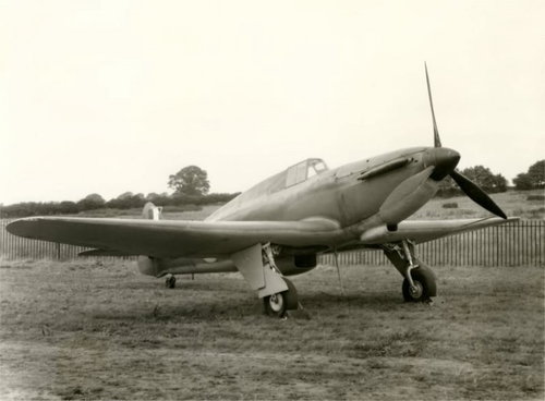

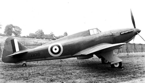

Pretty much it. It's worth noting that Defiant delivery to squadrons didn't match production; the hold-up being the manufacture of turrets. BP could have produced the airframe relatively swiftly with minimal modification; adding fuel tanks to the rear fuselage and so forth. This also meant that throughout the BoB (and the aircraft's short career as a day fighter) there were only two active squadrons that operated it, 141 and 264 Sqn. A photo from my own collection.

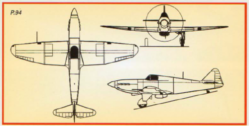

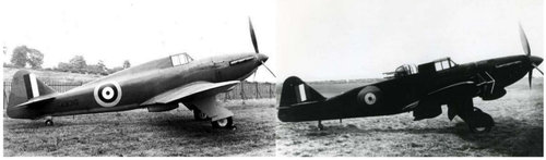

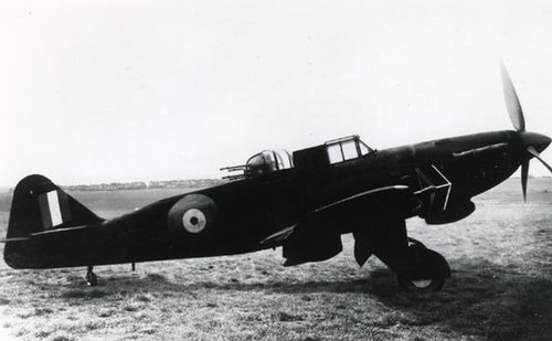

Thanks Blackkite. The second and third pictures show a Defiant NF.II fitted with AI radar. A single kill was made using the radar, but it was found to be difficult for the pilot to use and fly the aeroplane simultaneously. There was no room for the radar box in the turret. Note the larger radiator and oil cooler/carburettor intake of the Mk.II Defiant.
