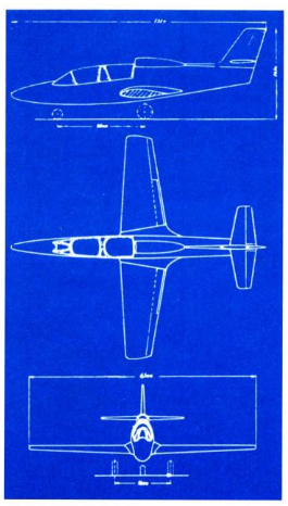

KBL-12 was a tandem two-seat low-wing jet-trainer and multi-purpose aircraft Project

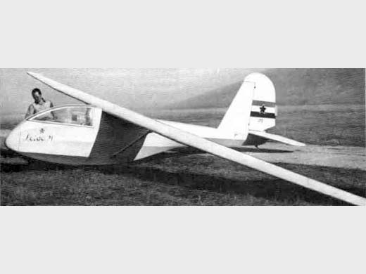

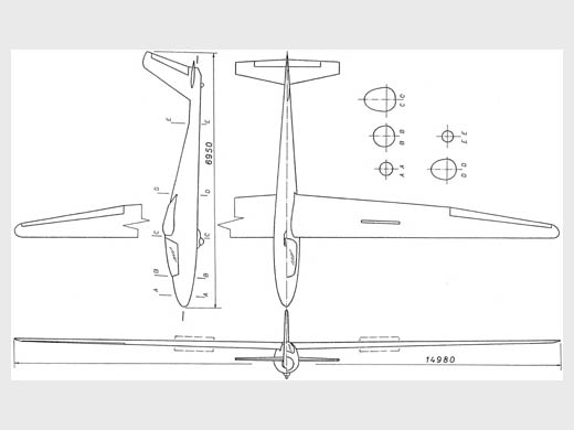

KB-1 - 1948 Triglav shoulder-winged sailplane
- KB-1: Single-seat high-perf. sailplane, span 15.00 m
- KB-1: Designed to 1947 comp'n for Olympic glider
-- Jaroslav Koser & Stojan Hrovat student design *
-- * Tehniška fakulteta of the Univerze v Ljubljani
-- aka Koser-Hrovat KB-1, Letov Kb-1, aka Koser K2A
-- Triglav after highest peak in Jura Alps
-- KB-1 based on Koser's 1946 Karavan glider project
-- 3v: https://www.modelarstvo.si/wp-content/uploads/2007/04/kb1_pro.jpg
-- https://www.j2mcl-planeurs.net/dbj2mcl/planeurs-machines/planeur-fiche_0int.php?code=1545

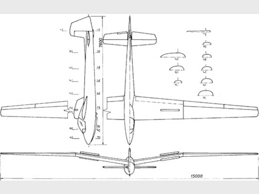

KB-2 - 1949 Udarnik single-seat sailplane
- KB-2: Shoulder gull wing, span 15.00 m, x 1*
- KB-2: Designed to 1947 comp'n for Olympic glider
-- YU-4014, laminar-flow wings failed to perform
-- KB-2 designed by Dušan Cener & Marjan Slanovec
-- aka Cener-Slanovec KB-2 Udarnik
-- Udarnik translates as 'Striker'/'Shock Worker'
-- 3v: https://www.j2mcl-planeurs.net/dbj2mcl/planeurs-machines/3vues/Cener-Slanovec_KB-2_Udarnik_3v.jpg
-- https://www.j2mcl-planeurs.net/dbj2mcl/planeurs-machines/planeur-fiche_0int.php?code=1562

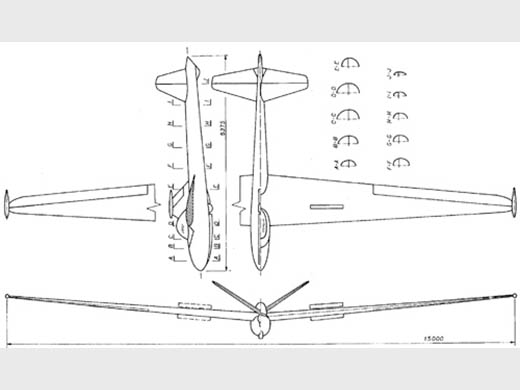

KB-5 - 1949 Triglav III shoulder-winged sailplane
- KB-5: Single-seat high-perf. sailplane, span 15.00 m
- KB-5: Triglav evol. with impr. cockpit, V-tail
-- Constructed by the Slovenian Aviation Association
-- aka Koser KB-5 Triglav III after Jaroslav Koser
-- 3v: https://www.j2mcl-planeurs.net/dbj2mcl/planeurs-machines/3vues/Koser_KB-5_Triglav-III_3v.jpg
-- http://www.aerozaprega.si/images/razno/kb5/slika2.jpg
-- https://www.j2mcl-planeurs.net/dbj2mcl/planeurs-machines/planeur-fiche_0int.php?code=3100

KBL-12 - (Project) 1954 tandem two-seat jet trainer
- KBL-12: Low-wing, version with side or top inlet(s)
- KBL-12: 1 x 150 kg turbojet engine,* span 6.50 m
-- * Engine speculated to be Turbomeca Palas
-- KBL-12 designed by ing. Marjan Slanovec
-- https://www.modelarstvo.si/kbl-12/

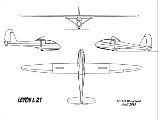

L-21 - 1955 'Libis' single-seat training glider
- L-21 : Braced high-wing glider, span (??) m
- L-21 : 1 (or 2), not considered successful
-- L-21 intended to repl. Utva Čavka gliders
-- 3v: https://www.j2mcl-planeurs.net/dbj2mcl/planeurs-machines/3vues/Letov_L-21_3v.jpg
-- https://www.j2mcl-planeurs.net/dbj2mcl/planeurs-machines/photos/Letov-21.jpg

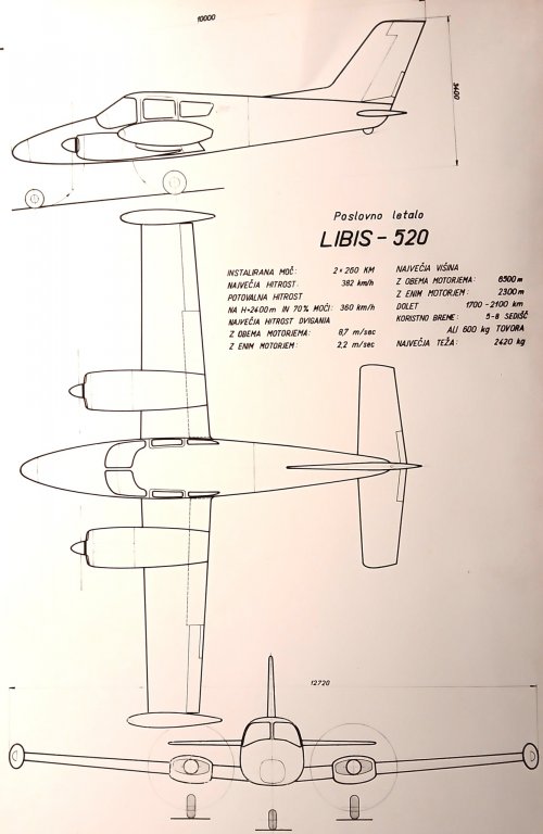

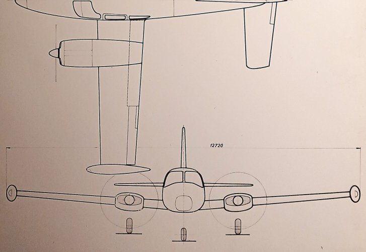

LIBIS 520 - (Project) 1956 light twin monoplane
- LIBIS 520: Low-wing cabin business aircraft
- LIBIS 520: 2 x (??) hp (HO6?), span 10.62 m*
-- Some say 12.72 m, ing. Marjan Slanovec design
-- 3v: https://www.modelarstvo.si/wp-content/uploads/2019/11/003_Libis_520.jpg
-- https://www.modelarstvo.si/libis-520/

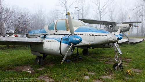

Amazing work as usual my dear Apophenia,
there was also LIBIS 200,but I will check from it.
Only small correction - its Udarnik, not Udarnika. While it means striker or even stormtrooper, properly socialist meaning is "shock worker" or "norm-breaker", Stakhanovite.
Some sites mention production of LET L-200 in Ljubljana but I found nothing about it in Czech (or Slovenian) sources.
