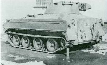

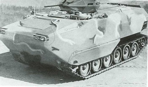

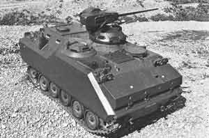

I am looking for line-drawings of the FMC Corporation’s XM765 AIFV and XM723 AIFV (Armoured Infantry Fighting Vehicle) developed in response to the U.S Army’s MICV 70 requirements.
Also of interest is information (Specifications, pics and line-drawings of the FMC Corporation’s LVT(X) design submission
Thanks in advance

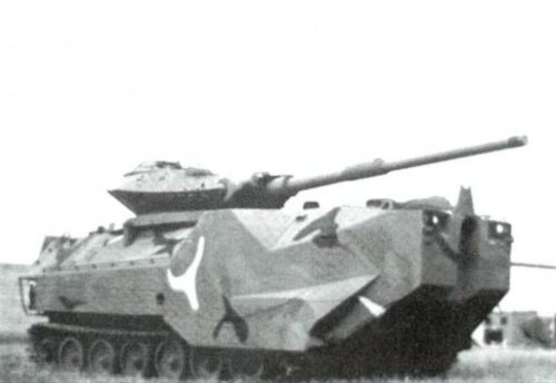

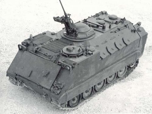

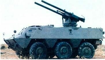

That last one, with the 90mm, I'd like to know more about.
It doesn't resemble any Cockerill, MECAR, or French (DEFA?) design I've ever seen...would like to know if it was derived from US 90mm guns (principally because the US was never really known for low-recoil 90mm guns, as that smallish turret suggests that gun would have to be...).
Such a U.S. equivalent of the PT-76 certainly might've changed the make up of Marine units generally equipped with just those "50/40" turrets on their LVTP-7s. Certainly would've given them better teeth against a number of targets upon landing.
The turret strongly resembles the Cadillac Gage 90mm turret found on the V-150/V-300 family. That turret had a Cockerill Mk III gun, but the tube in this picture looks wrong, like it's missing the muzzle brake. Perhaps the cover just disguises it?

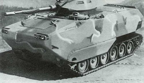

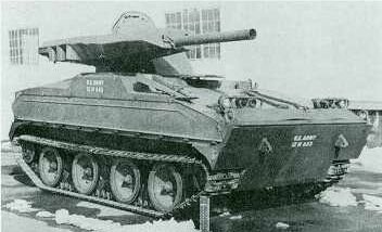

Found this on line can't remember which website it is come form,however it looks like an AAV-7 with a 90mm or 105mm turret and it is similar to the FMC's proposed LVT(X), with 90mm assault gun turret (based on M113A2).

Huh.
Learn something new everyday.
An interesting tale there I wouldn't mind hearing:
"The LVTEX-3 mated an expiremental Navy 105mm low-recoil gun in a surplus Army M551 Sheridan tank turret."
Interesting, because why would the Navy be expirementing with 105mm guns?

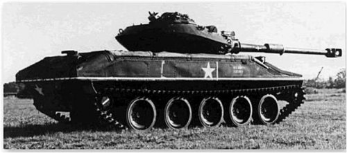

Not finding a thread on Sheridan derivatives, I'm going to post this picture of the Sheridan with 105mm gun here. If the mods would prefer creating a new thread, I'll be happy to oblige.

Outstanding,
many thx, Tom.
You might be onto something here. The LVT(X) requirement was for an Amtrac armed with an autocannon in the 25-35mm range. Perhaps FMC just stuck whatever turret they could find that could fit the ring with some kind of 'big gun' onto this prototype until the 25-35mm gun turret was available?

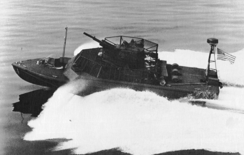

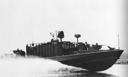

The Navy tested a modified Sheridan turret on a hydrofoil on the Hydrofoil USS Flagstaff.
There was also the 105mm on the ASPB.
http://www.sikorskyarchives.com/boat2.html
...So there was some navy interest along those lines...at least for brownwater forces. This would seem to easily transfer to AFV guns. It makes sense that they would be looking at ammunition and parts commonality with the leathernecks wherever possible. The 90mm Cockrill is a decent off the shelf solution but 105mm has the potential to use standard USMC ammo.
That was Sikorsky's offering for the Mk 2 ASPB which was in competition with the Stewart boat. The role of the 105mm gun was for direct fire bunker busting which the Stewart boat meet with a bow mounted 81mm breech loading mortar.

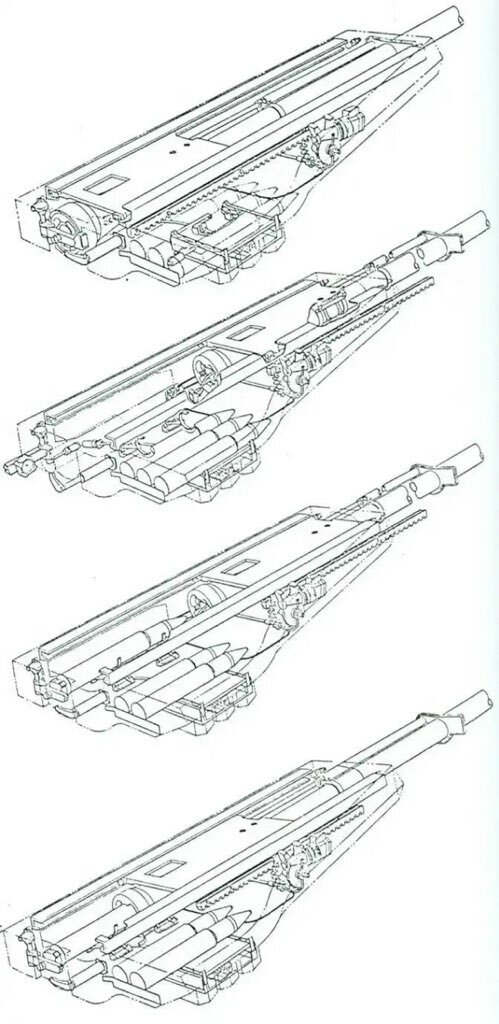

All of those pictures above are taken from Hunnicutt's book "Bradley". It does not have line drawings for the XM765 but does for the XM723 and FMC's LVT(X), the later without the turret. In relation to the LVT(X) Hunnicutt mentions that the gun version was armed with the 90mm Cockerill with 8 rounds in the turret and 32 rounds in the hull. Six dismounts could still be carried in this version.
Due to this webpage's policy of limiting scans from in publication or available to buy books I won't scan any of the line drawings. But get a copy of Bradley into your hands and all your questions will be answered.

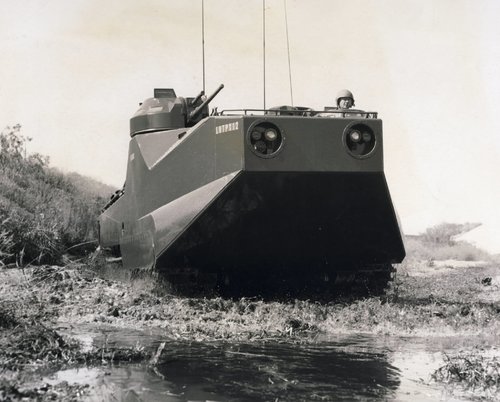

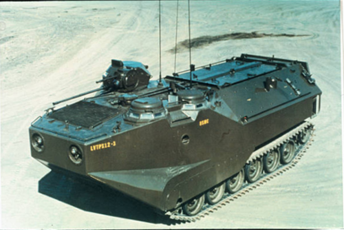

On the subject of the FMC (and Chrysler design LVTPX12 for that matter) LVTP-7, I'm somewhat confused.
Did the Chrysler designed and built LVTPX12
compete directly against FMC in the same competition? Or did FMC build the full production variant that became the FMC LVTP-7 for Chrysler?
Also if I may, I can't help notice Chrysler LVTPX12 was designed and built with one-man power-operated turret, armed with a M39 20mm cannon and 7.62mm machine gun. Does anyone know the make and model of this turret/cannon arrangementent and why did the USMC drop it from the production LVTP-7??

I have found the engineering report of the Chrysler study of the LVTPX12. Really love these LVTPX reports, they are so rich in data on automotive equipment and engineering.
