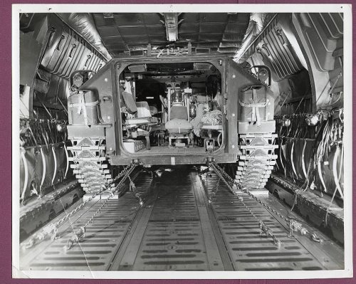

I've also just discovered that the original XM723 was specified (and was) capable to be airlifted by the USAF's premier cargo aircraft - the Lockheed C-141 Starlifter!

  • 1975 US Army Experimental XM723 MICV, being loaded into a Lockheed C-141 Starlifter.jpg
  • 1975 US Army Experimental XM723 MICV, inside a Lockheed C-141 Starlifter transport aircraft.jpg

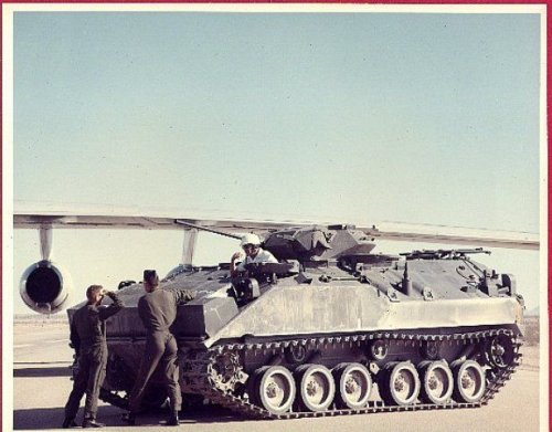

looking at that vehicle.. the bigger turret isn't what made it "too tall", which is one complaint i've seen from its detractors. the bigger turret didn't make it too tall.. it was really tall to start with. the turret just gave it the teeth to fight since it couldn't hide.

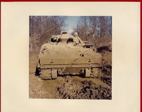

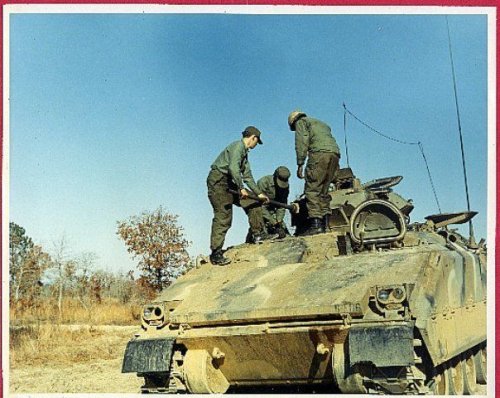

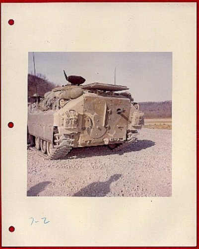

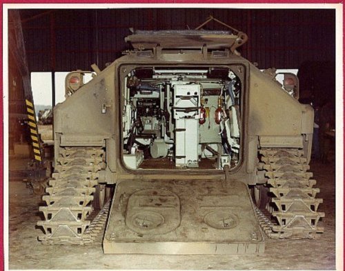

More views of the XM723 from ebay. I wanted to add these to help illustrate its design. :)

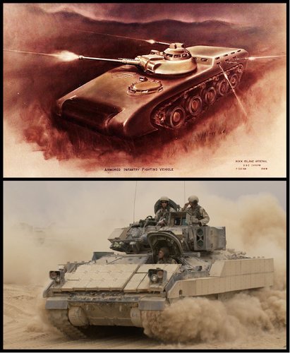

Not sure if this is relevant here - 1964 Weapons Command infantry fighting vehicle concept (complete with infantry firing ports) compared to the Bradley Fighting Vehicle:
615978
That concept would have been terrible for getting stuck in trenches.
It had a Hydropneumatic suspension if I'm not mistaken. That roller in the nose was also likely intended to further aid traversing trenches and rough terrain.
