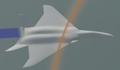

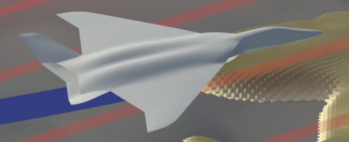

Japanese participation in the next U.S. fighter program is now conceivable because Tokyo has relaxed its arms-export restrictions, which in the past have largely prevented its industry from working with foreign partners. The way is not entirely open for cooperation, however, since Japan might be reluctant to supply some countries that the U.S. sees as suitable customers.
Stealth technology is also a feature of the F-3 program, as it has been for the i3 Fighter. That, too, is probably a hedge against failure to cooperate with the U.S., which is unlikely to need much Japanese help in that area when it designs its next fighter.
Other work flagged for the i3 Fighter might be enticingly dangled under the Pentagon's nose, though. The Technical Research and Development Institute and industry are working on skin sensors, directed-energy weapons and advanced avionics.
Arguing that neighboring countries—meaning China, South Korea and Russia—will have stealth fighters and longer-range missiles in the 2020s, the ministry is asking for ¥1.6 billion in fiscal 2013-16 to study integration of antennas into the skin of an aircraft, thereby helping to control radar reflections. The antennas would be those for electronic support measures, which listen to enemy transmissions, and electronic countermeasures (ECM), which jam and confuse them.
The ministry also wants to push ahead Japanese ECM technology, to preserve national independence in that area that was developed in building a system for the F-15. The ECM work must be part of what the ministry calls an “all-around surveillance and jamming system.” Japan is also looking for “reflection suppression” technology, apparently distinct from stealth shaping and materials. Details are unavailable. Results of this electro-magnetic work are to be assessed in 2019.
From fiscal 2010 the institute ran a ¥2.5 billion study on “internal weapons aerodynamics,” apparently an investigation into releasing bombs and missiles from bays, and now it wants ¥3.8 billion for further work, including a test rig.

Don't think it was posted before.
A concept of operations featuring miss february
fromhttp://www.lockheedmartin.com/us/news/features/2014/ahead-of-the-curve.htm
much larger size at http://www.lockheedmartin.com/content/dam/lockheed/data/corporate/photo/features/2014/post-2030-battle-space-scenario.jpg
That missile is an odd duck. Either it's some kind of hypersonic, conical RV-thingy or the 3D art guy was lazy.
I think it is just a placeholder for 'missile' cause they seem to have the same system coming from an F-16 Block 60, an SSGN, an LCS, an F-35 and the '6th Generation' air dominance 'platform' attacking airborne and ground based targets.
