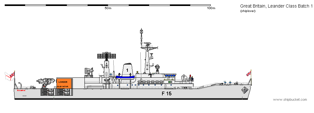

As far as I know, in mid-1950s the planned role of Seaslug SAM was changed (not the first time), and shifted from the carrier protection to surface ship groups and convoys defense. It was assumed that carrier groups would be sufficiently protected by carrier own fighters, and SAM's are more needed for convoy escorts and small tactical units, that could not have carriers for protection. Essentially, the only Seaslug-carrying ships ever build were County-class destroyers/cruisers, which weren't exactly numerous enough for convoy protection role.
My question is - would it be possible to create a Seaslug-equipped air defense escort on the basic of Leander-class (Type 12I) hull and machinery?
Such radical reconsturction, of course, would include removal of nearly all original Leander capabilities: 4.5-inch turret, Limbo mortar, helicopter hangar. Still, for dedicated air defense escort - designed to provide SAM protection for merchant convoys and amphibious assault groups - it won't be a critical loss.
So the idea is:
* Position the Seaslug launcher around the place of former Limbo mortar well;
* Use the corresponding space on 2nd deck to fit a missile magazine for at least 12 assembled missiles (side by side, two layer configuration) and crated storage for some diassembled
* Move the crew facilities (sick bay, mess, dining halls) into superstructure in place of former helicopter hangar
* Install Type 901 radar & corresponding equipment over it
* Add a Type 278 height-finder to work with available Type 992Q to provide targeting data for Type 901
* In place of former 4.5-inch turret, install a forward radar house with Seaslug fire control room inside
Something like that, presumably?

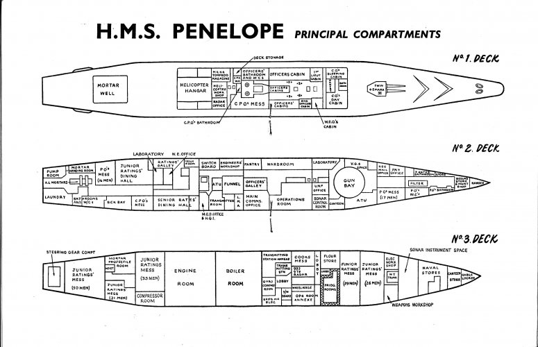

As shown in the drawing, it would not work. Seaslug needed two magazines. One stored the Seaslug without fins. Then came a room where fins were mounted and maintenance was carried out, followed by a third room where assembled, ready-to-use Seaslug were stored right behind the launcher. Overall, it was a complex system that took up a lot of space.
At what range a Sea Slug could hit a surface target? Nothing beyond the visual horizon?
Yep, strictly within the horizon missile. For surface shots, the Type 901 radar was slaved to Type 903 gun control radar; the Type 903 tracked the target, and Type 901 moved its beam accordingly in azimuth, with elevation calculated by range data. The missile was fired up by high elevation, then Type 901 depressed the beam at calculated rate, so the missile would descend toward the target. When the mimimal beam elevation was achieved (about 0.5 degrees), the radar sent "glide" command to missile - after recieving this command, the missile followed the beam in azimuth only, maintaining its previous descend angle.
Erm... No. The diassembled storage was not required. It was implemented on HMS London first and second batch of County-class as an attempt to increase magazine capacity. But it was not required for missile system to function; three first County-class have no disassembled storage.

It's the surface equivalent of a submarine.
Only one weapons system.
I don't think that's a design the Admiralty would approve of.
The base hull is just too small.
Hm, an argument! Maybe put the Seaslug on bow, then?
There's next to no volume in the Type 12 bow; Seaslug would extend so far aft that it would start competing with unimportant things like 'engines' and 'the bridge'.

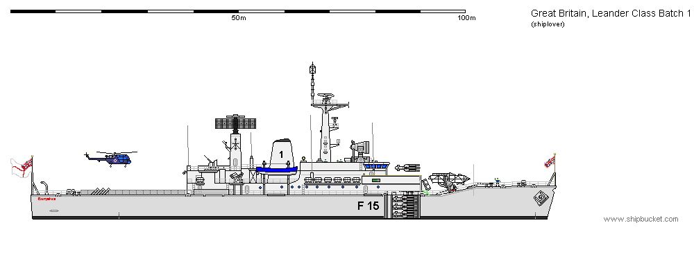

I know: the bow form is so fine that the 4.5-inch gun position is as far forward as the launcher could go, which means that the magazine (such as it is) has to go in the forward superstructure, wiping out the officers' accommodation and the operations room.
Incidentally, on the missiles-aft version you'd be amazed at how much resistance the Royal Navy would have to putting junior ratings on the same deck as officers. They might start thinking they were social equals!
This would allow be easier if Seaslug had been that bit smaller.
And even harder if Seaslug was an inline-boost weapon.
Erm, no. Launcher could be moved more forward, at least in theory. It's recoiless, so it doesn't need to be as heavily supported as gun mount.
So at least in theory we could move launcher further forward, placing elevator/check room over the former gun mount, and magazine below it.

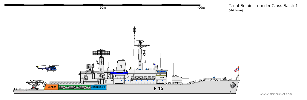

I've been doodling options for smaller seaslug on a modified Leander in shipbucket.
Having perused online deck plans I think the rear options be best, since the system would either site in place of the helicopter pad and hanger for a tube system (similar to a County) or replace the Limbo mortars and their ammunition storage in a vertical storage system (smaller seaslug being 15ft long this is viable and only 2 decks in height).

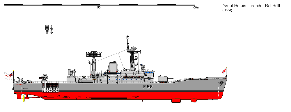

The problem with replacing the forward twin 4.5" is below the turret ring is accommodation spaces which would need relocation elsewhere.
Hmmmm. But would smaller Seaslug worth the efforts? Wouldn't its range be too limited?
More this was the hoped for outcome. For mkI 15nm range I don't think there's likely any real difference.
Maybe a delay on mkII 30nm range?

Theoretically, we could probably use something like pop-up launcher, raising from former mortar well on hydraulic lift. After all, it's not very likely that the frigate would need to use both helicopter pad AND missile system at once. Then we could use space beneath the helicopter hangar for missile storage.
Another idea - to cut the stern just behind the helipad end, thus creating enough space for launcher to work (probably with raising bulwarks to protect it in heavy seas).
