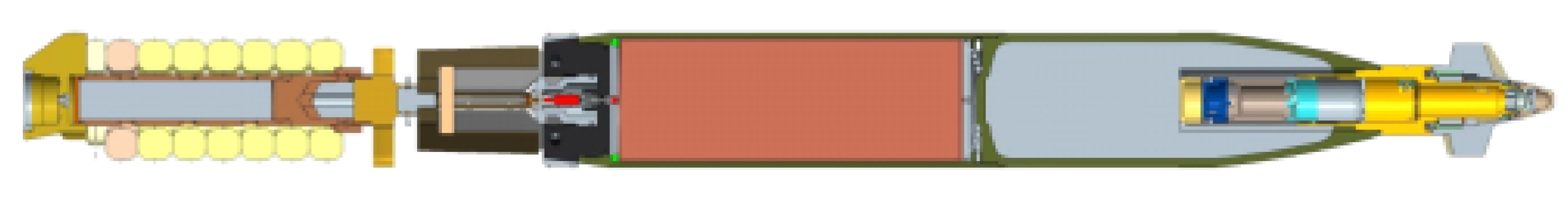

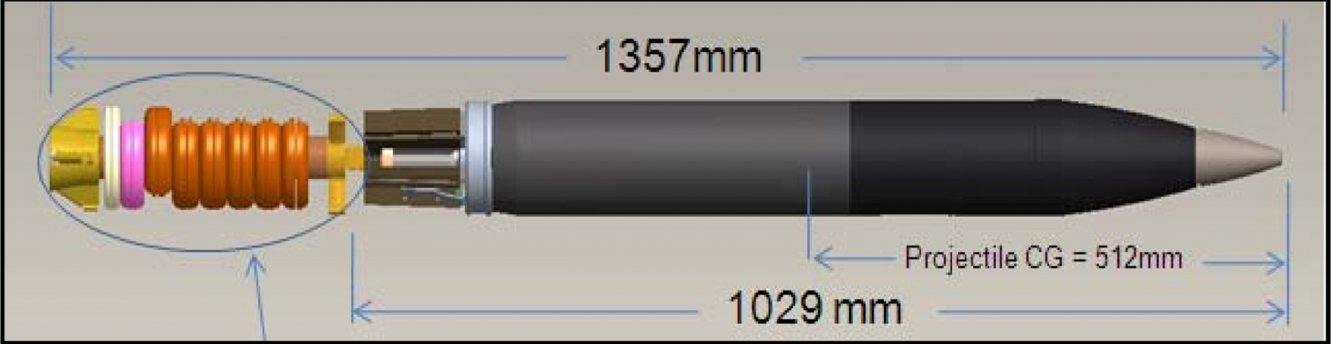

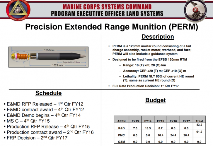

Starting off with some images, mostly of the unsuccessful ATK and General Dynamics Design:
Sources for the last three images:
https://ndia.dtic.mil/wp-content/uploads/2012/mcsc/Shrader.pdf
https://ndia.dtic.mil/wp-content/uploads/2017/mes/CSPWright.pdf
  • Shrader.pdf
  • CSPWright.pdf
