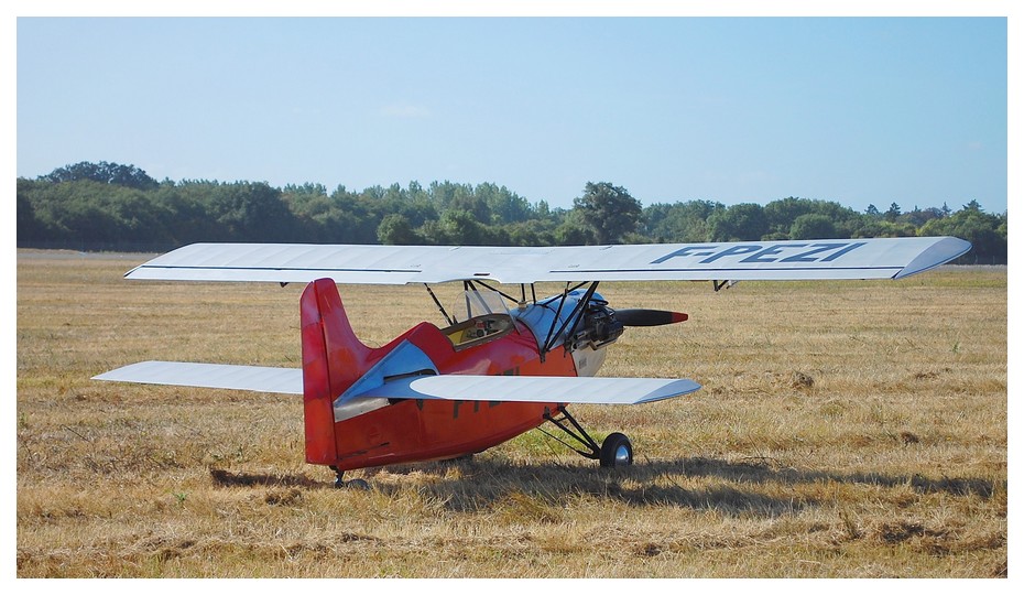

A couple of years ago there appeared on le Bon Coin (a French online advertising site) a Mignet formule aeroplane. I attach a copy of the image that accompanied the advertisement and apologise for the diminutive size of it (it was the best I could capture). It was being offered for sale at only a few hundred Euros. As I've said, it appears to be a Mignet formule design but not one which I recognise. Sadly before I could make enquiries of the seller, the advertisement was taken down. Can anyone out there identify it?
P.s. I should add that when it was being advertised for sale on le Bon Coin, there was a hyperlink to a video (on, I think, youtube), which showed this aeroplane being taxied frantically around a field, but my attempts subsequently to find this have been entirely unsuccessful.

I didn't think that this little aeroplane would defeat the mighty intellect of this forum!
For me , it looks more like a tandem wing plane (Peyret) than a Pou (Mignet) ...
http://pouguide.org/un-cousin-eloigne-la-denoiselle-de-denoix
But my understanding of the Peyret double monoplane design is that it had ailerons on all four wings (q.v. the SFCA Taupin and Cross Country designs - SFCA acquired Louis Peyret's patent after his death in 1933). I can see no ailerons on the wings of the aeroplane in my photograph, which led me to assume that the forward wing pivots and the aft wing is a fixed aerofoil and, from that assumption, that it had been constructed on the Mignet formule.
