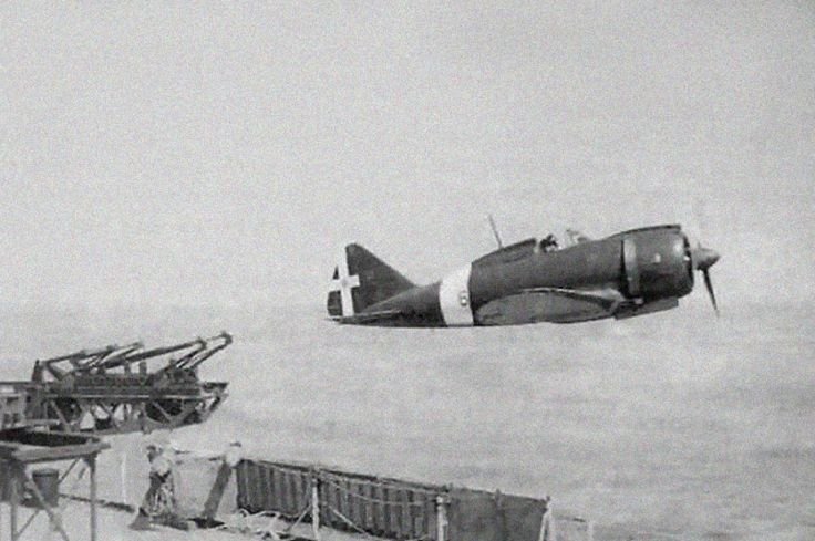

I've seen illustrations of Italian battleship(s?) having Hurricat-like Italian fighters on their catapult, so that part seems credible.
The purpose was likely to get rid of shadowing British scout planes.
