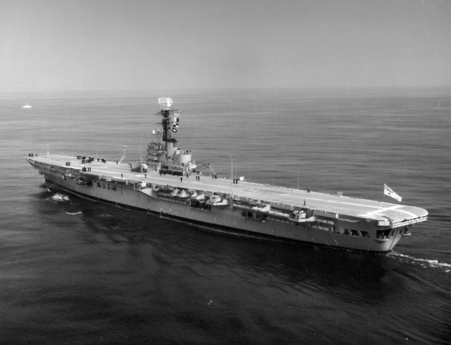

As I understand things, the hard part is the stacks and uptakes. Those can be moved, but it's a lot of redesign work.
My thought was to leave them where they come through the flight deck but rearrange the island around them. You can move the island overall at least 30ft forward and maybe 50, all without messing with the uptake locations. And then you add a whole new Pri-Fly area wrapped around the inboard side of the stack.

Borrowing wiki's photo of HMAS Melbourne here, you can see where the uptakes/stack are in the middle of the island. Which also means you can see how far forward my proposal would move the island.
Note that if we're slapping an angled deck on there and widening the flight deck, that involves relocating where the uptakes are anyways so we can do a better job in making the island work without having busy parts of the structure in poorly-accessible places.
