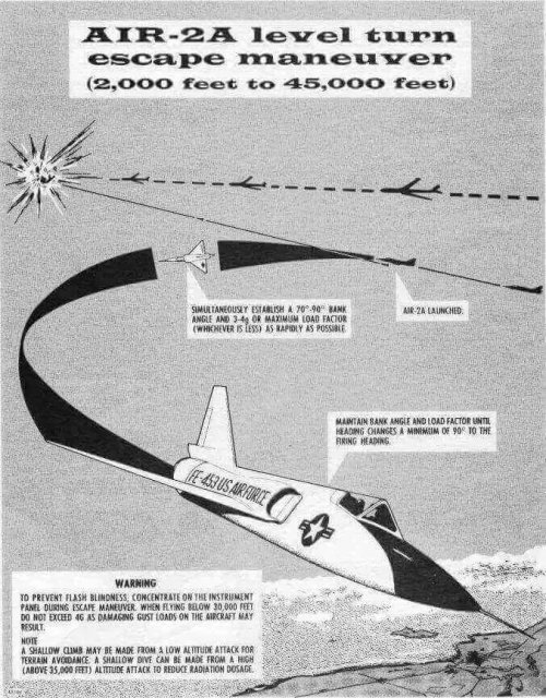

Really depends on the airframe-lethal blast radius of 1.5kt... Wiki says ~300m, which seems small to me but I suspect it's due to reduced air pressure at 30-40kft.
Hrm. I'm getting
https://www.airandspaceforces.com/article/1197linebacker/
So that may be far enough apart to avoid the entire flight getting smashed by a single missile detonating close to the center.
Formation cell distances in Linebacker were were dictated by mutual ECM self-defense requirements.
"Linebacker: View from the Rock"
The instruction manuals seemed to assume each Genie was only going to destroy 1 bomber. The real advantage of a nuclear warhead was that even if the missile didn't directly hit, it would still down the target.
