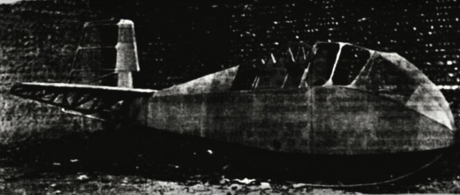

Here it is although a little poor quality. Taken from the sale advertisement ;-
ADVERT FROM APRIL 1947 SAILPLANE AND GLIDER FOR SALE.
The "Lancia" Cabin Sailplane. complete with A.S.l. altimeter, variometer and cross level. Simple to rig, ailerons and flaps couple up
automatically, Price, complete with trailer with new tyres, £300.-
Apply Mrs. Dunning, 3…………..
Sussex.
After building a sailplane based on a Dickson Primary, Herbert J Dunning built a Grunau Baby II (BGA 220) and a Flying Flea (G-AEEF).
The "Lancia" was a 50ft-span flapped sailplane based on a Grunau Baby, with an enclosed cockpit and provision for a removable engine, designed by G A Little; construction begun by Dunning at Worthing in 1938, perhaps using parts from BGA 220.

Thank you, Zoo Tycoon. I'd missed Mrs Dunning's April 1947 advertisement in my trawl through S&G! However I don't know where you found the illustration attached to your post. That doesn't seem to appear in the April 1947 copy of S&G that I can access. I'm also ignorant as to the source of the information contained in the second paragraph of your post. Will you please enlighten me as to that?
Info supplied by a member of the VGC and comes from their archives.
Looking back at the message sent, yes the photo was not attached to the advertisement. So strictly speaking the photo is claimed to be the Dunning Lancia.
Thank you, Zoo Tycoon. I sent an e-mail to David Williams of the VGC, last Saturday, but I've yet to receive a response.
