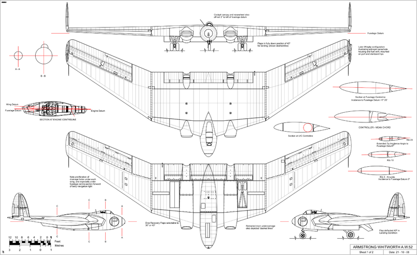

I received from the late Barrie Hygate a copy of his CAD drawing folder when we were working on the P.1121 book containing hundreds of drawings in various stages of completeness. When I did my P.1121 book the process of converting to a usable drawing was slow and complex. Now, using Affinity Designer 2.0, its pretty fast. So, here's a drawing from Barrie's collection of the Armstong Whitworth AW.52.

Maybe some of our experts on the AW.52 can comment if this is good. It's not a subject I know.
No expert but I do notice quite a few differences in detail between this and the drawings produced by Chris Sandham-Bailey to accompany Tony Buttlers article in Aeroplane April 2013. Do any original AW GA drawings exist? I know of some for the 52G and some internal equipment layouts for the 52 but nothing else.
Can't say I'm a fan of Barrie's use of heavy lines for the panelling, rivet lines etc.

This is indeed true, but the differences go beyond those kind of tweaks. I have a partial drawing with detailed dimensions, found on Facebook somewhere, that appears to bean AW original which would indicate that Barrie is indeed accurate.
Line widths are adjustable, and often don't import correctly from the CAD originals, so its a judgement call on me as the converter.
For some of Barrie's drawings in my P.1121 book I removed the rivets and panelling detail, especially where the drawing was reproduced at a small size, as it got very cluttered.
I would love to have these scans. I avoided scanning from the book, because I didn't want to break the binding. Plus you don't get the distortion from the binding with these. Whatever you scan is much appreciated.
I've noticed occasional errors on Chris Sandham-Bailey's Database drawings for Aeroplane (usually minor slips, things like features being missed from top views that are on the side view etc.) and occasionally I wonder how accurate some of them are in terms of smaller details. I'm not saying that they aren't good, but I suspect that Barrie put in a lot of effort into his drawings as a labour of love rather than to meet a publishing schedule. And to be fair the Database sometimes includes esoteric types where good source materials might be lacking (the next one being the Blackburn Kangaroo for example).
