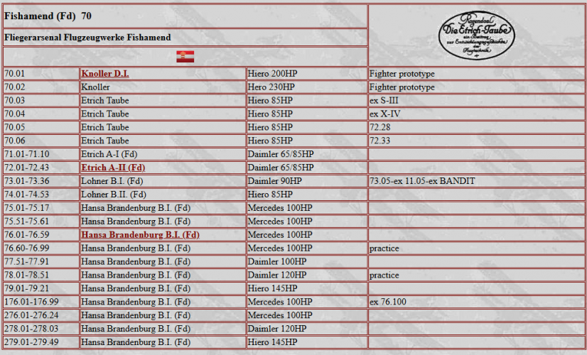

Amazing work as usual my dear Apophenia,
and from old Polish site.
Interesting that your clipping lists Bauart 176 as "ex 76.100". That makes it sound as if there were bigger differences between the Ba 76 and Ba 176 than just the controls set up. I wonder what those changes were?
