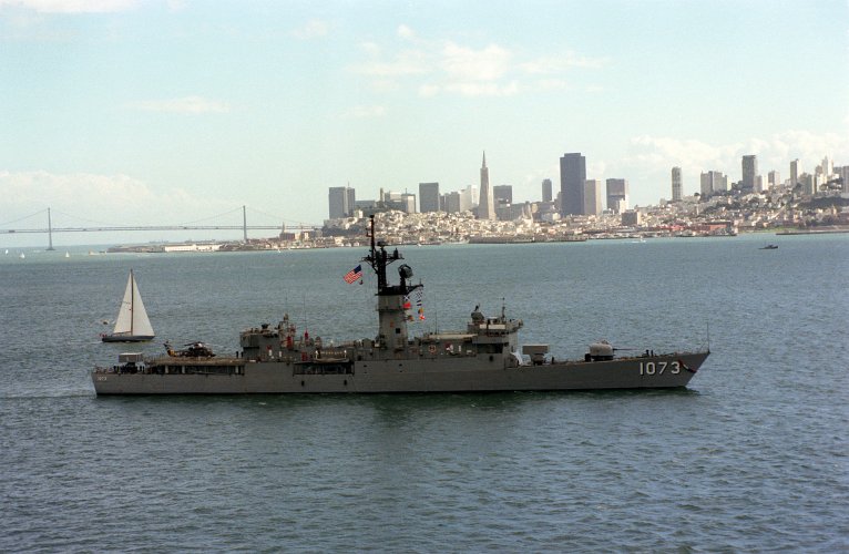

Well, they did make it aboard the Knox class... on the stern:
True, but Knox-class weren't exactly "small units".

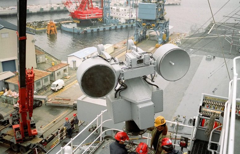

From a modern point of view they were small. BPDMS could also be installed on FRAM ships, but then instead of the Asroc, not because of the weight, but because of the size. Or instead of the drone on their landing platform. That was not the purpose of these ships. All guided missiles were larger than ww2 weapons, so the ships were also larger. BPDMS was ideal as light weapon on aircraft carriers as additional weapon on cruiser and destroyer. An it did well, because it was smaller and lighter than Tartar.
The missile system now known as Crotale NG. It was a competitor in the ADATS competition where it was called Liberty VT-1, and did well enough to be adopted by France. Has radar tracking, thermal tracking, and visual tracking, with radar and IR search systems.
It became the Clemenceau and Foch close air defense system after early 1980's mid-life SLEP, replacing old guns. Just like CdG has Aster 15 nowadays.
Theoretically it could be installed in place of upper turret (which was already removed on FRAM II ships), but the space would be rather tight.

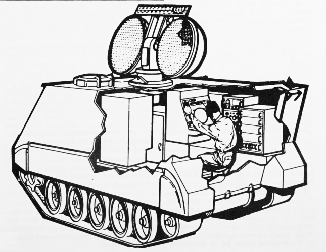

There was Americanized Roland, but that was limited and short-lived:
"In 1979, low-rate initial production of the XMIM-115A was approved, so that operational evaluation could begin. However, in 1981 it was decided to terminate the US Roland program and limit procurement to a single Army National Guard battalion only. American production ended in 1985 after about 600 missiles had been built. The US Roland was never declared fully operational (and therefore the missile retained its "X" prefix), and the only battalion eventually deactivated all its Roland assets in September 1988."
See:
