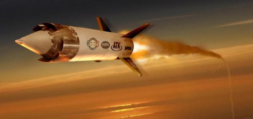

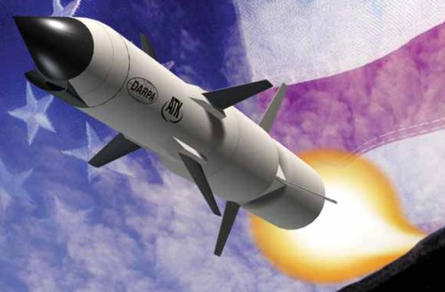

found this ad in DARPA - 50 Years of Bridging the Gap
something unknown for me - any help?

Re: DARPA/ATK High-Speed Strike Weapon (HSSW)
Hypersonic High-Speed Strike Weapon (HSSW)
ATK is developing a Hypersonic High-Speed Strike Weapon (HSSW) in response to the Department of Defense’s need for a rapid strike weapon.
The design for the HSSW uses ATK’s solid rocket motor capabilities to boost the weapon to Mach 4, where a scramjet engine engages to accelerate to speeds approaching Mach 5. The HSSW can be launched from bombers, fighter jets, submarines, and surface ships.
The scramjet acceleration capability of the HSSW builds on ATK’s success with the X-43A Scramjet, which owns the world speed record for air-breathing powered flight at Mach 10 or nearly 7,000 miles per hour. Flying at half that speed, the HSSW can fly 400 miles in eight minutes. In comparison, a cruise missile flying at a top speed of Mach 0.8 will take an hour to reach the same target.
Although the picture on ATK's website looks different it has a similar configuration, like solid rocket boosted with air breathing powered flight after separation of the booster.

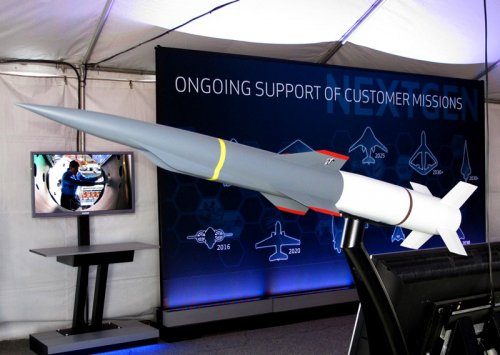

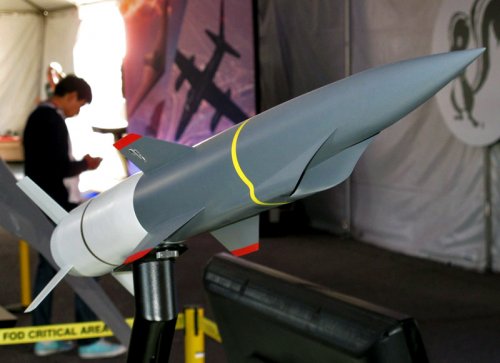

A model, recently on public display.
Seems sensible enough, a TBCC missile would seem more likely than the "SR-72" in the current environment anyway.
The pictures on the display behind are also quite interesting.
