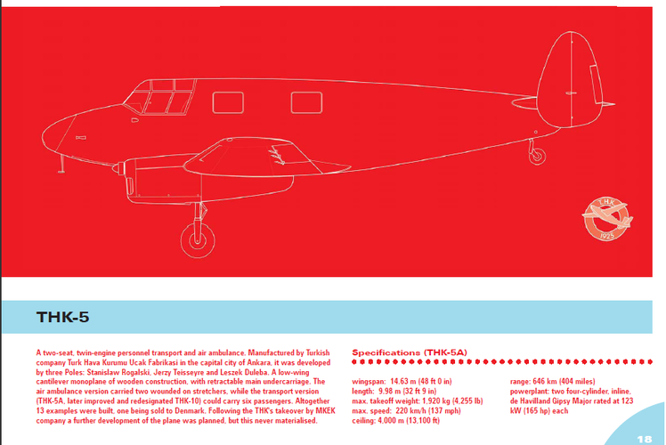

from Air International,here is a more Info about the THK company's aircraft and projects,from THK-1 up to THK-16.

THK-5 -- 1945 twin-engined, low-wing, cabin monoplane, x 13
- THK-5 : 2 x 165 hp DH Gipsy Majors, wooden const., span 14.63 m
-- THK-5 air ambulance was the prototype for the series THK.5A/THK.10
-- http://www.flightglobal.com/pdfarchive/view/1949/1949 - 0547.html
- THK-5A: 6-seat utility transport vers., x 9
- THK-10: THK-5A development (see below), x 3

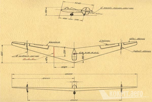

THK-13 - 19?? tailless aerodynamics research glider, 65' 7" span
- THK-13: Flying wing, wooden construction with fabric covering
-- http://www.flightglobal.com/pdfarchive/view/1949/1949 - 0546.html

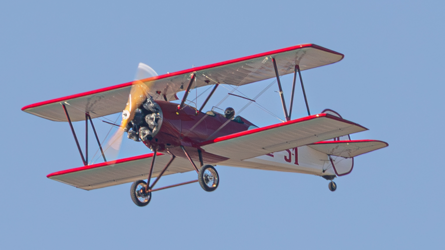

Vecihi XIV 1931 | recognized as Turkey’s first certified aircraft and its first home-built civilian plane.
Replica built by 11 man team at Mach Teknik in collaboration with the Sivrihisar Aviation Club and the M.S.Ö. Air and Space Museum, achieving about 75 % similarity due to the scarcity of original drawings.

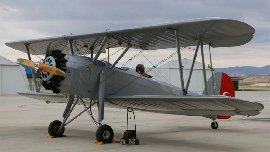

Nu.D-36 1934 | served primarily as a trainer for the Turkish Air Force from 1936 to 1942.
Again by Mach Teknik team led by aerobatic pilot Ali İsmet Öztürk, under the Sivrihisar Havacılık Kulübü (Sivrihisar Aviation Club) - The team says it achieved around 80 % similarity.
