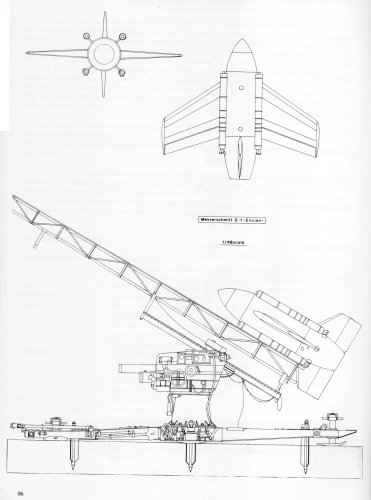

Justo Miranda said:
My opinion
The Enzian came to my mind yes.
In the text tho, it is mentioned that the unmanned rocket interceptor would shoot at the bombers and then evade to land and be used again later on. Definitely not the Enzian then.
