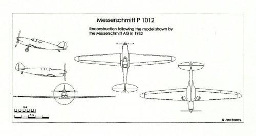

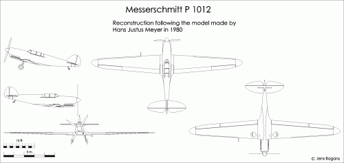

When I had a look into the M 34- file again, I stumbled about the P 1012 designation.
IIRC, I started this reconstruction, when I found an article about it in an Flugzeug Classic issue.

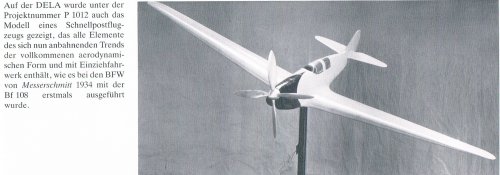

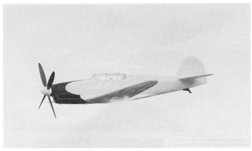

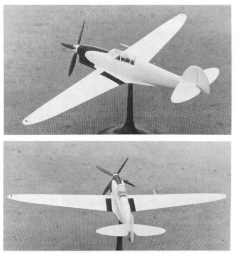

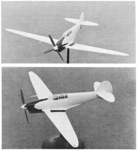

what was this Messerschmitt project ?,in Luftfahrt 11/1980,they spoke about
many aircraft,and I can't ID it,here is the whole article,any help please.

It's the P 1012 , already shown here ( :) )
Various Messerschmitt projects
From the " Willy Messerschmitt" by Ebert , Kaiser , Peters published in 1992 by Bernard&Graefe Verlag :

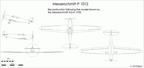

Hi Hesham
From our friend Jemiba (Jens Baganz)
toura said:
Hi Hesham
Yeh,thank you my dear Toura,
I know P.1012 very well,but I though that Model was not for it,of course I was wrong.

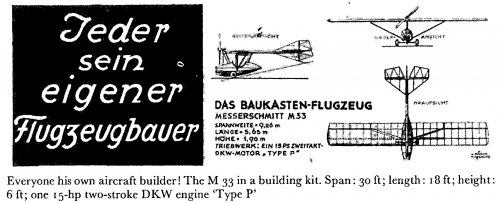

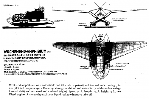

According to Messerschmitt; Aircraft Designer by Armand van Ishoven, the M 32 was a very unusual "weekend" amphibian NOT designed by Willy Messerschmitt but some other unnamed individual.
It would have had two diesel buried in the fuselage driving a single prop mounted above the center-line, and would have used a rocket for take off boost. I could swear that I've seen this posted elsewhere on the forum, but cant seem to find it with the search feature.
This data also conflicts with what is posted in the messerschmitt designation thread, that states the M 32 was a biplane trainer that later became the He 72. This is somewhat in agreement with Willy Messerschmitt: First Full Biography of an Aeronautical Genius by Frank Vann, which states that the M 32 was for a biplane trainer that progressed no further than a few early drafts made by Messerschmitt himself. Quite confusing no?

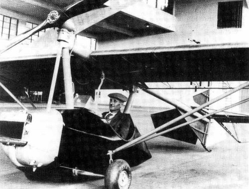

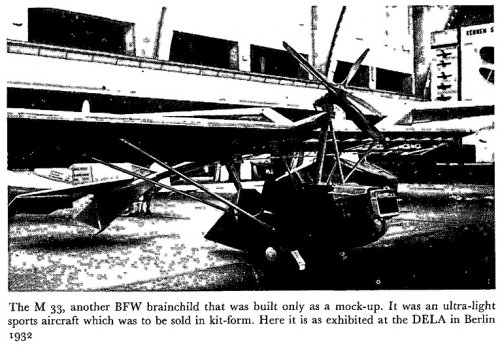

The M 33 was for another novel design. Vann states that Willy was inspired by the Volkswagen, and decided to make a peoples plane, using a DKW 15hp engine and sold as a kit for home builders. Like the M 32, this progressed no further than the mockup stage. This mockup was shown off at the 1932 DELA (Deutsche Luftsport-Ausstellung) exhibition in Berlin, along with mockups of the M 32 and M 34. Hopefully this info leads to some pics of that M 34, which very well could be sitting behind the 33 in the attached pics.

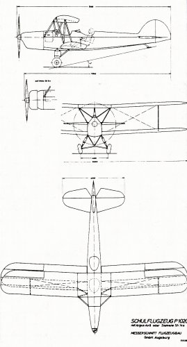

The Messerschmitt M-32 was an other design, this description is wrong.
The Amphibium is the BFW-Kleinherz Wochenend-Amphibium.
M.33
Thank you my dear Sienar,
but my dears Maveric and Jemiba are right.
From Messerschmitt,Armand Van Ishoven.
