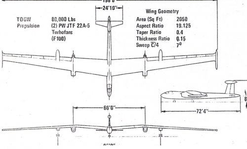

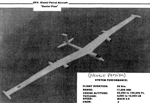

SENIOR PINE was the name given to Boeing's GPX (Global Patrol Experimental aircraft), which was itself derived from the OSSA (very high altitude Ocean Surveillance System Aircraft) proposal.

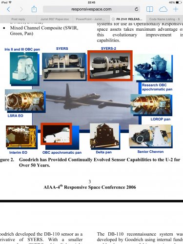

Here's my list, based on info I found at http://www.designation-systems.net/usmilav/codenames.html some time ago (added a couple of bits in it):
Senior Blade ELINT/SIGINT program, U-2 related
Senior Blue Air-to-Air Anti-Radiation Missile (?) link
Senior Book U-2R COMINT system, used on flights from OL-20, 1970s-1980s
Senior Bowl 2 B-52Hs '60-0021' and '60-0036', modified to carry 2 Lockheed D-21B "Tagboard" reconnaissance drones link 1 | link 2
Senior Citizen Classified program; probably a projected Special Operations stealth and/or STOL transport aircraft topic | link 1 | link 2
Senior CJ Northrop/Boeing/LTV B-2A stealth bomber; continuation of Senior Ice
Senior Crown SR-71 reconnaissance aircraft, based on CIA-sponsored A-12 "Oxcart" link
Senior Dance ELINT/SIGINT program, maye U-2 related ?
Senior Glass ELINT/SIGINT program, U-2 related
Senior Guardian Grob/E-Systems D-500 Egrett, high-altitude surveillance / reconnaissance aircraft, German-US cooperation, 1980s link 1 | link 2
Senior High Study program for potential stealth applications in 1978, which led to the F-117A, B-2A and other stealth aircraft
Senior Hunter C-130E/Hs used for Senior Scout reconnaissance/ELINT missions, and/or maybe support aircraft for EC-130E(RR) / EC-130E(CL) Commando Solo missions; Conflict? Support of the shelters used by Rivet Rider, Volant Solo, Senior Scout
Senior Ice ATB (Advanced Technology Bomber) stealth bomber design by Northrop; won design competition against Lockheed Senior Peg and was developed as B-2A under Senior CJ program link
Senior Jade USAF Special Access Program
Senior Jump U-2 ELINT/SIGINT program, related to Senior Book
Senior Keyhole covers all overhead (photo) reconnaissance satellites
Senior Lance U-2R with Goodyear SAR in inflatable dome
Senior Mace SIGINT exploitation system
Senior Open U-2R with rotating LOROP camera nose system
Senior Peg ATB (Advanced Technology Bomber) stealth bomber design by Lockheed/Rockwell; lost design competition against Northrop/Boeing N-14 Senior Ice link 1 | link 2 | link 3 | link 4 | link 5
Senior Pennant Classified stealthy air-launched cruise missile; USAF study under JTACMS (Joint Tactical Missile System) program; evolved into AGM-137 TSSAM (Tri-Service Standoff Attack Missile) link
Senior Prom Stealthy air-launched cruise missile by Lockheed link 1 | link 2
Senior Ruby U-2R with E-Systems ELINT/SIGINT gear
Senior Saber ELINT/SIGINT program, maybe U-2 related ?
Senior Scout PHOTINT/ELINT package/modification (a roll-on/roll-off shelter, fitted with DCPS - Data Collection & Processing System) for C-130E/Hs, including: EC-130E(CL) '63-7815', C-130H '74-2134', C-130H '89-1185'
Senior Shuffle ELINT/SIGINT program, maybe U-2 related ?
Senior Sky ATF (F-22) development of stealth fighter, Lockheed link
Senior Smart ELINT/SIGINT program, maybe U-2 related ? link 1 | link 2
Senior Span U-2R satellite data link, aka 'C-Span III'
Senior Spear U-2R with ELINT/SIGINT pods, at least 4 different Phases: I, II, III, IV, 1980s
Senior Spur ELINT/SIGINT program, U-2 related
Senior Stretch U-2R with ELINT/SIGINT pods
Senior Surprise AGM-86C CALCM (for Operation Desert Storm in 1991)
Senior Trend Lockheed F-117A stealth fighter, follow on to Have Blue link 1 | link 2 | link 3
Senior Troupe AN/AIC-38(V)2 communication system
Senior Warrior Marine Corps PITINT/ELINT system; uses Air Force Senior Scout on USMC C-130s
Senior Year covers all overhead (photo) reconnaissance aircraft; SYPO (Senior Year Projects Office), located at Warner-Robbins AFB, GA, (oversees all SENIOR programs, not all are on aircraft; the U-2 main logistics support depot is also at Warner-Robbins); SYERS (Senior Year Electro-optical Reconnaissance System, not only used for U-2s link 1 | link 2
