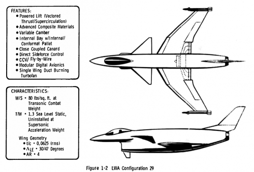

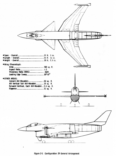

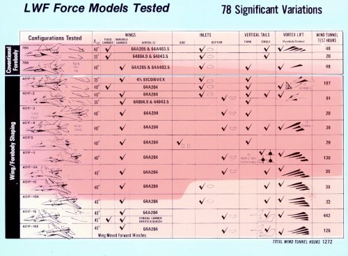

This being said, I would tend to be extremely cautious before inventing the designation "Model 29" for it. "Configuration 29" indicated one of several sub-variants of a basic type, usually represented by a hyphenated suffix (for instance look at the attached chart for the F-16 development). Besides, configurations such as "26B" (page 122), "26C" (page 124) "27" (page 125), "28" (page 137), "32" (page 176), etc. all prove that these are just iterations of the same basic LWA design. The real model number for the LWA program is nowhere to be found in this document.

“The objectives of this technology integration study for close air support aircraft are to perform configuration design and validation using, in part, man-in-the- loop simulation techniques. An advanced technology close air support aircraft configuration known as Lightweight Attack (LWA) Configuration 29 is evolved and justified. The selected configuration embodies powered lift in the form of vectored thrust with supercirculation (VT/ SC) and an advanced composite structure. Other advanced technologies which are integrated in LWA Configuration 29 are direct sideforce control (DSFC), variable camber, internal/conformal pallet for stores carriage, close-coupled canard, and modular digital avionics. Results of the study show that such an integrated advanced technology configuration provides significant improvement in total tactical fighter mission capability and in the ability to perform and survive in the ground attack environment”. (Author-PL).
