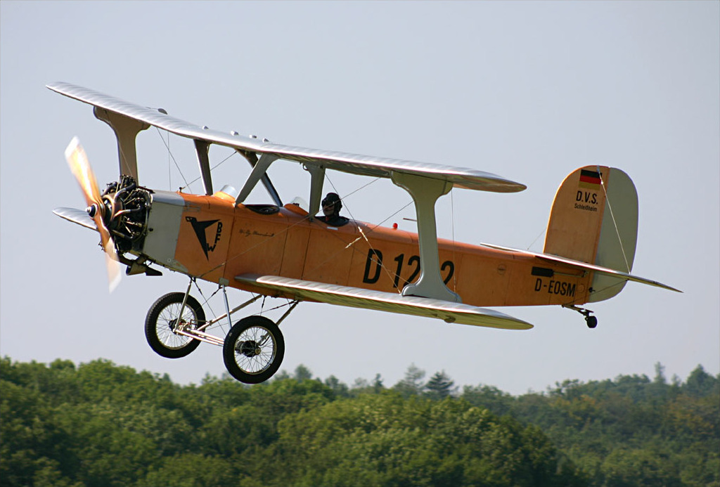

Manfred Weiss WM-3 -- 1932 Hungária 2-seat biplane trainer
- WM-3: WM Hungarian-licensed Udet U 12 Flamingó, x 40
- WM-3: 1 x 125 hp WM-Siemens & Halske Sh 12 radial, span 10.00 m

  • Hungária I: similar to U 12a with N-type interplane struts
  • Hungária II: similar to U 12a with N-type interplane struts
  • Hungária III: similar to U 12a with N-type interplane struts, propeller spinner and Townend ring
  • Hungária IV: similar to U 12a. Only Hungarian-built version with I-type interplane struts
  • Hungária V: similar to U 12a with N-type interplane struts
Apophenia,
I think the WM.5 is not right,and the early WM five designations as I guess are
here;
Hmm, ... having five 'MW' designations for the Hungarian Udets doesn't really make sense.
Although there were five Hungária variants, half of those licensed U-12s were built by KRG - not by Manfréd Weiss. So, why would there be 'MW' designations imposed upon the Flamingos built by another firm?
I guess the research question now is: Which of those five Hungária variants were built by Manfréd Weiss?
