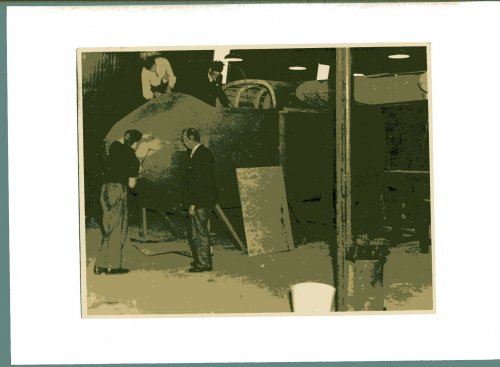

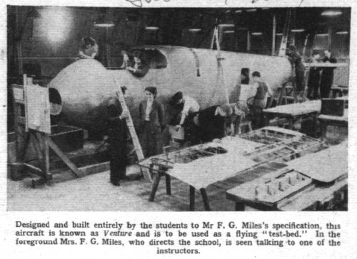

Has anyone ever seen or heard more about this little-known project? Or the "high-performance sailplane that's also mentioned in the article? Even the Putnam book only gives the Venture project passing mention. (DOESN'T!!) Thanks to anyone who can contribute!

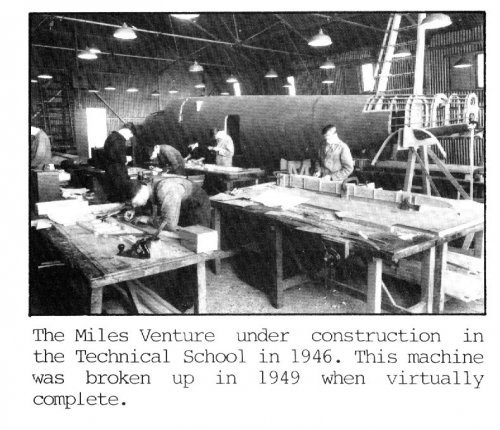

That's a new one to me, Stephane, bravo. The text says it was destroyed when almost complete, I wonder if there are any former Miles Technical School students left that might have a photo or drawing?
There's another photo in a book called Miles Aircraft from the Archive Photographs Series. The accompanying caption says: 'An important part of Miles operations was the Technical Training School which was established at Davis Farm near Woodley Aerodrome, with the particular backing of Blossom Miles. The students constructed the fuselage of the TS Venture - a twin-engined aircraft intended as a testbed for Miles lightweight autopilots, but the project was not completed beyond the stage seen here.' (which is as the photos above - somewhat contradicting the assertion that it was almost complete when abandoned)

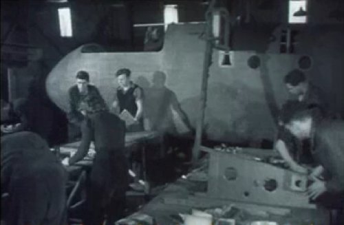

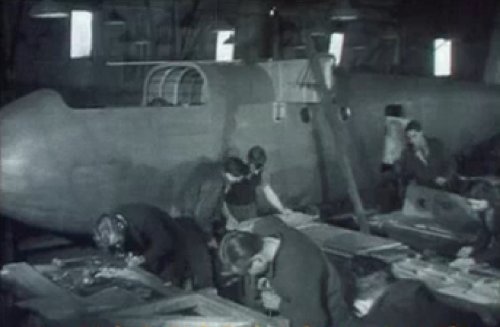

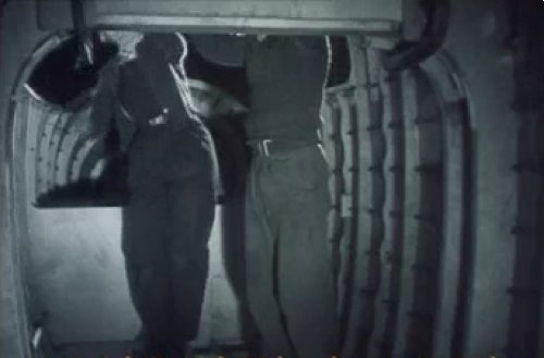

Just can't believe what British Pathé has put online... A 4-minute excerpt of a 1947 video newsreel film dated 30 June 1947 about the Miles Technical School. You can see Miles himself and his wife supervising the students and above all the students at work on the Venture!!!

In various scenes of that film papers, plans and even the big drawing board can
be seen, but resolution is insufficient to see the drawings itself. Could they be
recognised in a better quality ? Is that film available in better quality ?
Would help a reconstruction ... ::)

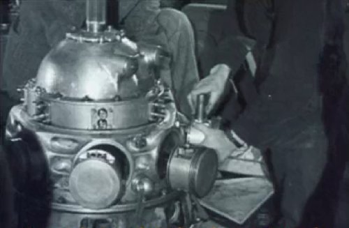

What's the type of the engine shown ? Maybe an Armstrong Siddeley Cheetah ?
Don't know, but the good news is I should be able to provide more information, pics and even an original three-view drawing very soon, directly from the Miles museum curator, via another forum member who will forward them to me so I can scan them and post them. Indeed, Christmas DOES come VEEEEERY early this year!!!
I would say, yes, you're spot on, perhaps one of the earlier models as this one has a plain, bowl-shaped bell housing where the later Cheetah IX and X seem to have had a larger diameter housing with flutes at each bolt. See the Wikipedia entry and pics on the Cheetah and elsewhere.
Thanks for the confirmation of the engine type. And now we really could expect
something much better. I'm eagerly looking forward !

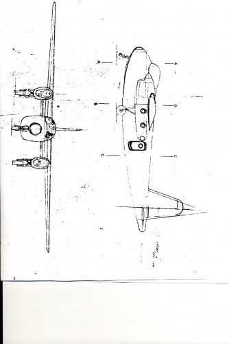

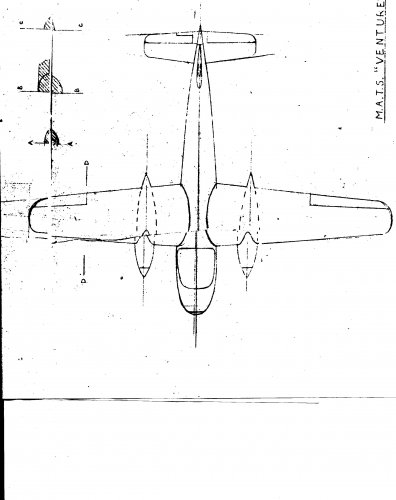

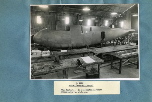

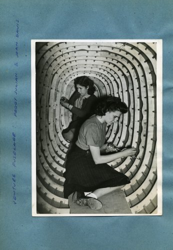

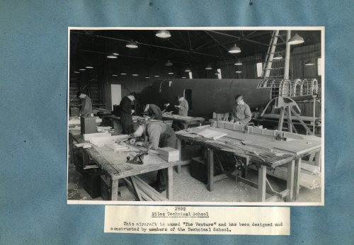

Sorry it took some time, but the documents from the museum are finally here.
I had to wait a little more than I'd imagined at first because I waited for the digital versions (I could have scanned the copies made from them but that would have been a bit silly!). So here goes, straight from the mid-forties for your enjoyment.
"Another Secret Projects Forum exclusive." LOL ;D
All attached documents are published here courtesy of
Jean Fostekew, archivist, The Museum of Berkshire Aviation.
www.MuseumofBerkshireAviation.co.uk
Thank you so much to Ken and Jean Fostekew for their help, and Paul "Toura" Touratier of course.

Is there any clue, if two versions were planned ? The drawing shows inline
engines, from the film, I would have thought, that radials were prepared to
be fitted, but those scenes, showing assembly of the engines may have had
no relation to the Venture, of course.
Wonderful stuff, thanks so much, this is a great addition to my Miles collection. On the engines, I suspect that whatever appropriate powerplants they could get cheap or donated was the most important criteria, but you're right, the earlier photos didn't actually say the radials in the picture were for that aircraft. Did anyone find any dimensions or projected peformance specs for this forgotten treasure?

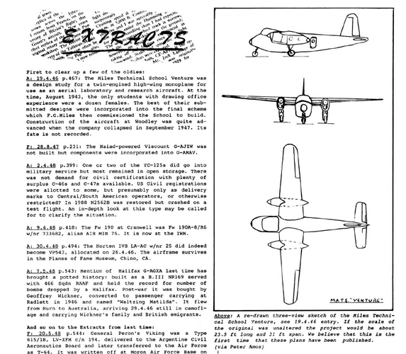

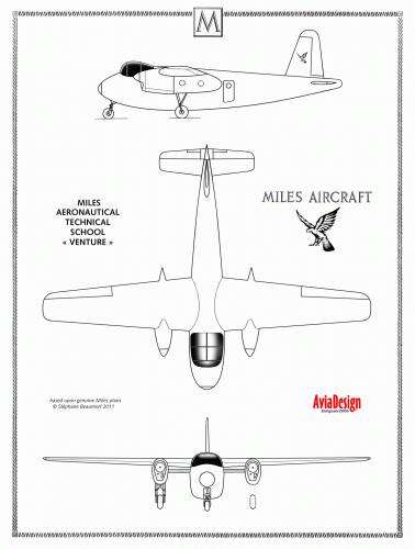

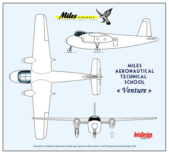

Until we manage to find more information such as the specs, allow me to contribute the very first ever decent three-view of the Venture. I'm aware it's not perfect, and in a couple of cases I had to make decisions that can be debated, such as when several lines seem possible (vertical tail in profile view, upper wing in front view for instance). Of course I'm open to any manner of criticism that could make me improve this three-view drawing... Enjoy!
A very pleasing 3-view, Stargazer2006. I cannot comment on the minutiae of accuracy, but it is nevertheless, a real pleasure to view. Well done.
