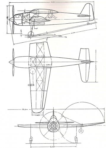

Hi! Kugisho's plan for high speed long range carrier base dive bomber after the loss of the Midway sea battle.
Wing Span : 12.5m, Over all length : 10.5m, Height : 3.8m, Wing Area : 26.5 square meter, Gross Weight : 4,700kg, Maximum Speed : 340knot(630km/h),/Altitude 6,000m, Range : 2,200n.m.(4,074km) with No25 bomb, 200knot(370km)cruise, 2,100n.m(3,889km) with No50 bomb, Armament : 13mm gun one. Engine : Mitsubishi MK9(A20)
Blackkite,
many thanks for that. I see that also Japan went towards longer range attack aircraft designs. The idea was to beat enemy fleet from unexpected directions.

Perhaps this aircraft was called as "Wakusei (惑星, the planet)". (This information is Baed on recent Maru magazine.)
It was an airplane of the interim existence of Suisui(彗星) and Ryusei(流星), and was the last dive bomber which the IJN planned.
