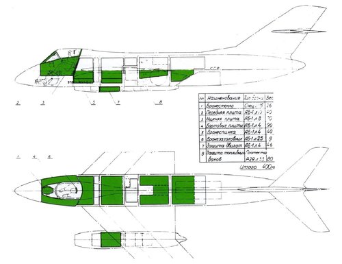

1) The 1969 Yak-LSh or Yak-25 LSh project (mid-plan) was based on the basis of the Yak-25 interceptor fighter
2) The amended version of the project (high-wing plan) of 1971 bore the official designation Yak-LSh-2 (inside the design bureau it was secretly called Yak-28Sh)
It should be noted that between them was another intermediate version of this project.
3) The link provided by redstar72 is an article by Viktor Drushlyakov from Aviation and Space Review.
google translation
