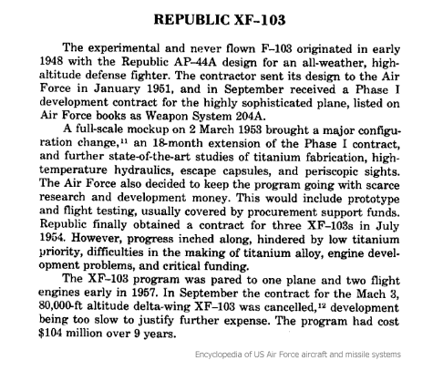

Steve, the Encyclopedia of U.S. Air Force Aircraft and Missile Systems concurs with your version of THREE aircraft ordered, and gives JULY 1954 as the date of the contract.
This might help if you know the contract dates of the planes immediately before and immediately after the unaccounted for batches.
