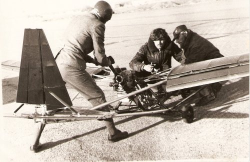

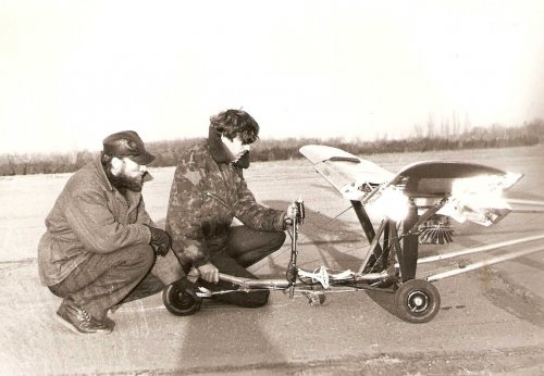

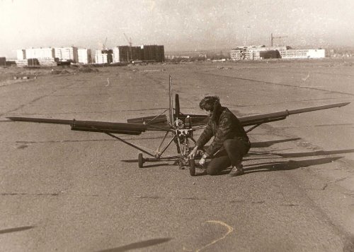

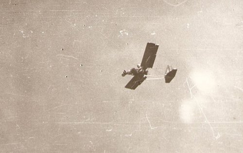

Some more info here:
http://www.reaa.ru/cgi-bin/yabb/YaBB.pl?num=1154592957/all
Specifications:
http://forums.bmaa.org/attach.aspx/7128/Dmitriev.pdf
Also, I'm having some trouble with this:
http://forums.bmaa.org/attach.aspx/7127/X-14Translation.pdf

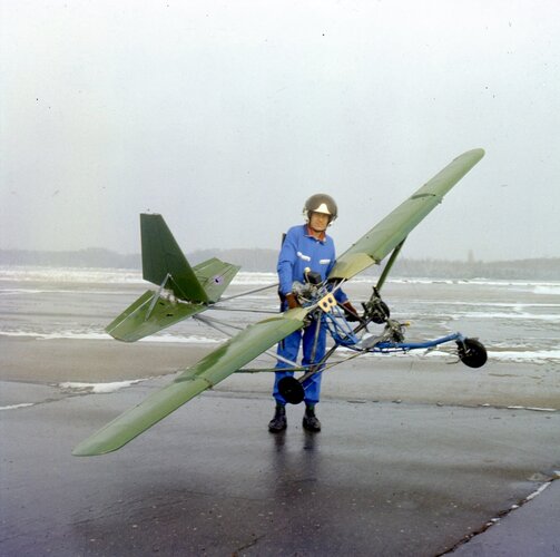

Particularly the words 'intertseptor' and 'shank'. However, it does confirm that this is almost certainly the smallest aircraft ever produced to have a triple-slotted flap with slats!

In addition to figuring out the meanings of the words "intertseptor", and "shank" (slotted controls?)...
*edit* intertseptor apparently means spoiler... shank I'm not so sure about though...

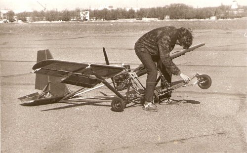

Thank you. Looking at the photographs the tabs seem quite large for trim tabs?
Also, any idea why it needed spoilers?
To change airfoil camber.
Roll control, in addition to the ailerons.

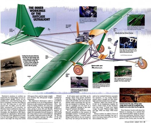

Cutaway Dmitriev X14
Motorcar, thank you for drawing!
That's particular case, when word "cutaway" didn't correspond to the illustration :cool:
There are very few things, that could be revealed under the skin of this ultralight
Aha! Thank you!
So, the control surface itself consisted of a bunch of segments that changed shape and had slots! Interesting.
Avimimus said:
Aha! Thank you!
Validates your observation Silencer1 and I am aware that cutaway is not the right word, but just use it to provide the "Search" Internet more easily locate that image, so whenever I share some schematic cut initially use the word "Cutaway"
