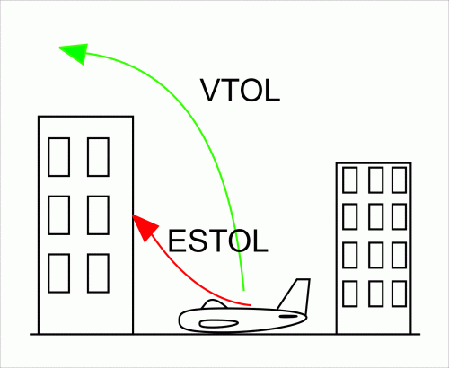

Jemiba
ACCESS: Above Top Secret
Mar 11, 2006
8,303
1,317
Avimimus said:
... Do the design tradeoffs involved in making a VTOL jet (e.g. high thrust to weight ratio) benefit any other capabilities?
Am I wrong, or would for example the F-15 have been (theoratically) able to take off vertically,
given its thrust/weight ratio ?
- For quite a time there were thoughts about launching fighters from ships fitted just with heli
pads, probably unsuitable even for ESTOL.
- Several VTOL aircraft were designed for beingn launched from forrest glades, as giving them
the most secure cover, when on the ground.
- VTOL passenger jets were seen as a high speed replacement of helicopters for inter city routes.
What has to be taken into account are the reasons that were seen for real VTOL. So I cannot fully
agree to the title. Reasons and tactics are changing regularly and I wouldn't be that sure, that we
won't see pure VTOL coming up again one day.
