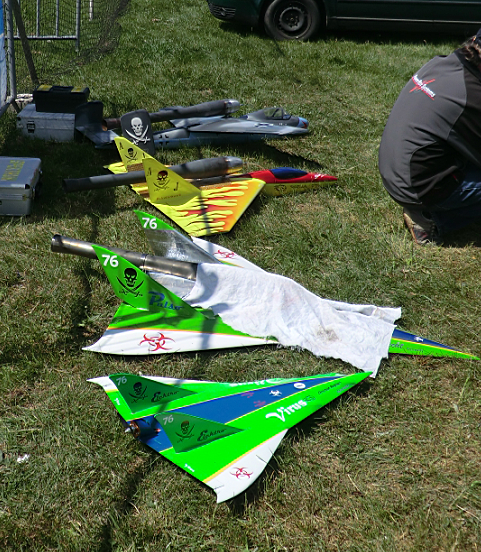

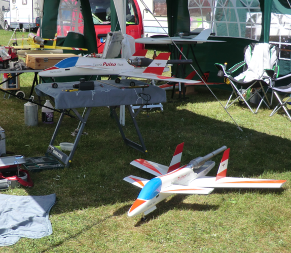

As Justo already pointed out, pulsejets actually are used on RC-planes. If you want to see more of them, keep an eye on the little town Rothenburg (but Rothenburg in the Oberlausitz, not at the Tauber !), especially on the "Luftfahrtechnische Museum" (aeronautical technical museum) there. Here's a link to the report about last years event there :
https://days-of-speed-and-thunder.de/rekordzahl-an-piloten-beim-16-pulsotreffen-in-rothenburg/
The name is motto, and this probably is a reason, that this type of propulsion isn't as widespread, as electric propulsion. And as southwestforests pointed out, you need a large area, as most of those models are really fast.

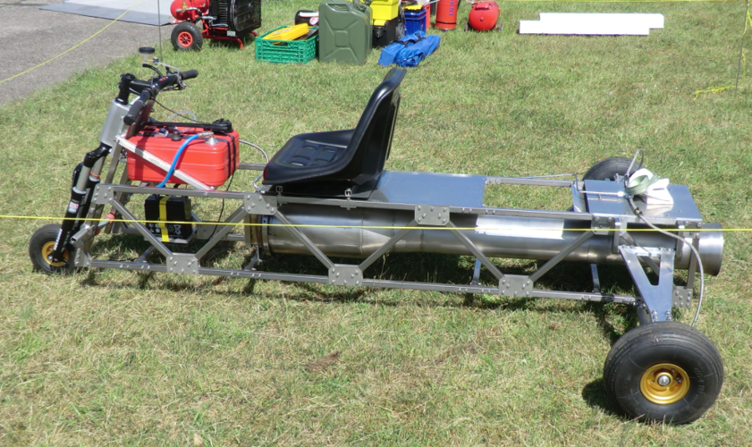

Attached are some photos I took at this event in 2015, and no, not every vehicle powered by a pulsejet there was flying ...

That last one, did anyone ever start the engine?

Thanks for the tip. I will propably have to visit them at some point. Those are still different from Ramjets, though somewhat similar. I think ramjets are just fascinating because of their increadible mechanical simplicity.
