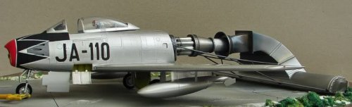

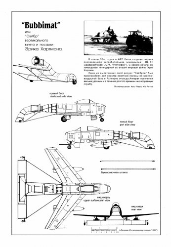

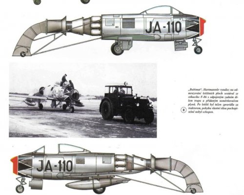

While browsing through Russian aviation magazine AeroPlan #15, I came across a most intriguing contraption made up of the front end and jet engine of an F-86 Sabre fighter and a sort of strange exhaust pipe on wheels that make the whole thing look like a vacuum cleaner for airport strips!! As I speak neither Russian nor any of the other Slavonic languages that the machine was mentioned in, and in the absence of any other source of information, I hope someone on this forum can help me understand, not only what the whole thing was about: when it was done, by whom and for what purpose... and also why it seems that the name of Erich Herman, a famous pilot from the Luftwaffe, seems to be associated with it...

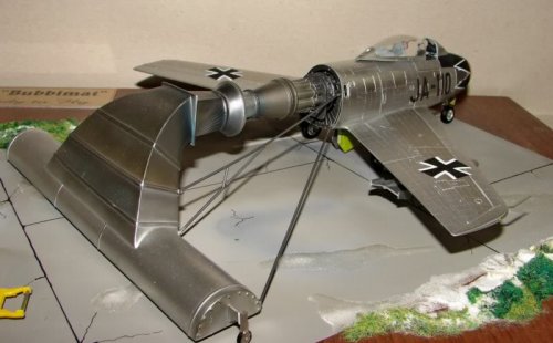

I don't know, if SOC is right, although I think so, but I want to add two points:
- The correct spelling certainly is "Bubimat", I took the liberty to correct the title.
- Erich Hartmann survived the war and served in the "new" Luftwaffe again,
until 1970. His nickname was "Bubi" Hartmann, so I think, this thing somehow was
based on his ideas, as he was flying the Sabre himself.
Edit: The scan clearly shows "Bubimat, too. ;)

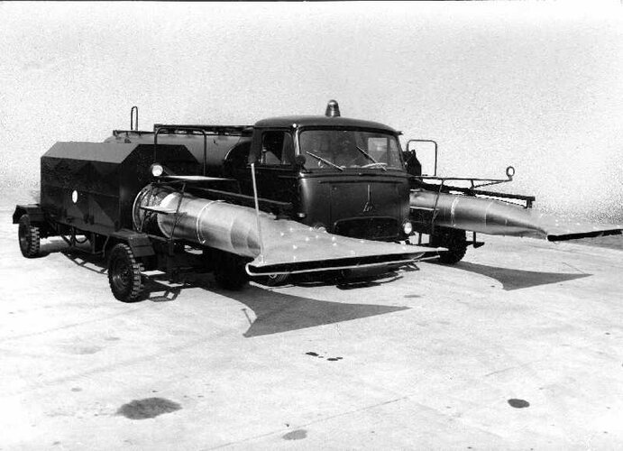

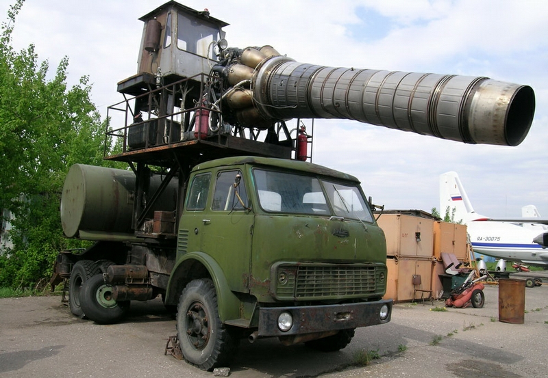

Another jet powered de-icer (source http://englishrussia.com/2011/02/14/wackiest-russian-vehicles/)

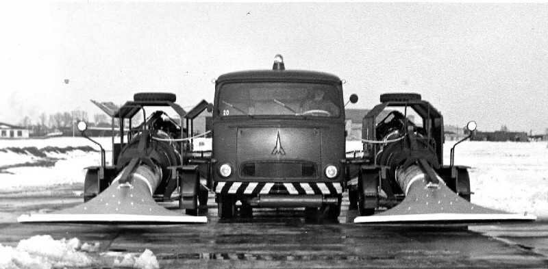

While researching for my blog post about the "Bobbimat", I found that in the book "Die Flugzeuge der Bundeswehr 012 - Canadair Cl-13A Sabre MK 5" by Peter Sickinger there is a mention that this particular contraption was tested on CL-13A Mk.5 s/n 932.
In the same book, there is also a mention that the german company Schoerling Waggonbau builded a snowblower truck attaching two Orenda 10 engines (coming from Sabres Mk.5 s/n 817 and 852) to a Magirus-Deutz tanker truck. This contraption was called Startbahnenteisungsgerät, thermisch and it was used in the Hanover Airport.
Here are a couple of pictures of it:
Pictures source: http://www.specialtrucks.ch/001_ola...tlich/eisabtaugeraet_schoerling_seitlich.html

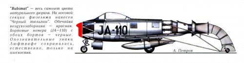

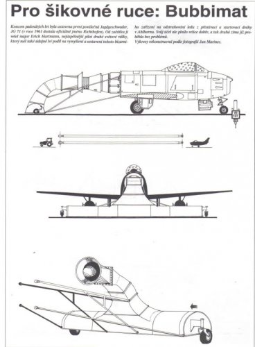

According to text at picture it was device for RWY Deicing. On the Sabre exaust were installed bubimat and the plane was towed behind a tractor. The designer was Erich Hartmann (know german fighter pilot)
