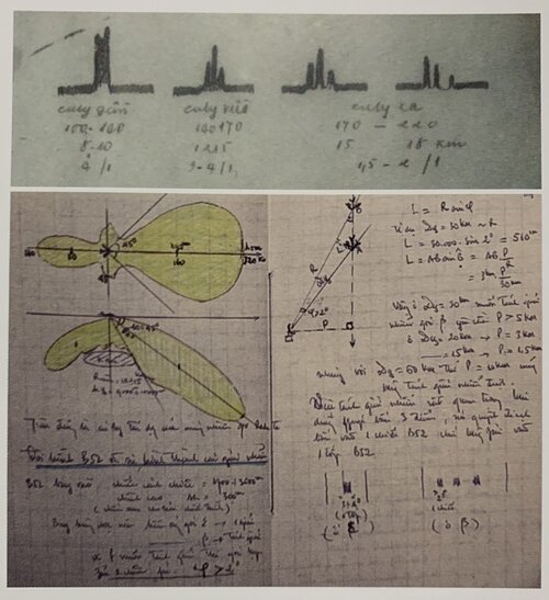

Does anyone have a drawing of the jamming coverage of the B-52 during its post-target turn?
I remember seeing one in a book that shows the B-52's jamming coverage lifted up - not pointing downward - in a 90-degree bank turn.
Good luck finding that in English without a classification marking. The BUFF is a 2 g airframe so 60 degree banks are the most you get for something level. No comments about coverage or turns, I've sat next to an EWO in the BUFF on a range going against threats.

My bad, should used more specificity, the thing in English would be coverage pictures. The bank angles are pretty consistent, 60 degree level turn = 2g, pretty basic airmanship question (even engineers should have that one memorized).
