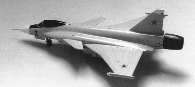

I thought Lockheed's interest was in the Yak-143 - which seems to be a very elusive project?
