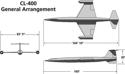

I'm of the opinion that the Tsybin RSR much more closely resembles the Lockheed CL-400 Suntan than the A-12.
Tsybin could not know a dime of Suntan as first drawings of RS appeared back in 1954
Hmm, well I suppose that was just a case of convergent designs resulting from convergent requirements, then.
