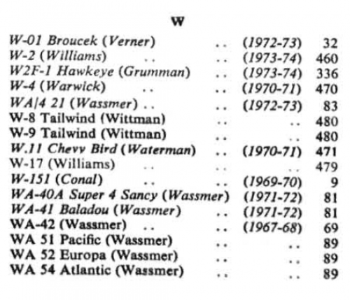

Thank you my dear Skyblazer,
and there was also W-12,and for W-11; JAWA 1975-1976 index.
Thanks for providing the source to the W-11 designation.
I suspect W-12 must have been for the Chevy Duck, which was the Chevy Bird after it was modified with floats.
On second thought, I'm not so sure about the W-12 being the Chevy Duck.
The NTSB website mentions the W-12 as [N6039], an airplane that was damaged during tests in 1971 with Waterman himself on board.
The W-11 was [N262Y], which wasn't changed when it became a seaplane. Also, this site clearly gives the W-12 as a landplane:
https://www.aircraftprofile.com/aircraft/waterman-w-12-0562045.php
So it would seem the W-12 was a different machine after all. Thanks for bringing this designation to my attention!

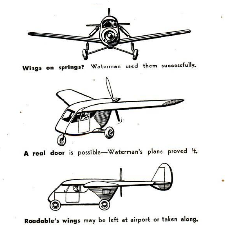

From Flying magazine 1948-6,
what was this Waterman design ?.
In my opinion, the top drawing is the W-1 Flex-wing. The two other drawings combine various features of the W-4 Arrowplane and the W-5 Arrowbile. I'm not a Waterman expert, but I do not think they accurately depict any design.
