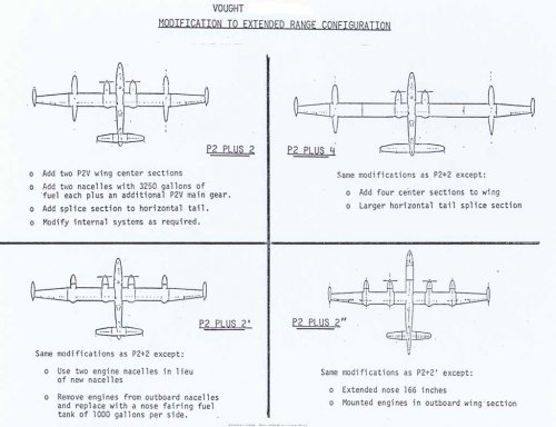

In the Vought Archives I found one notebook about Project Stork.
It was an attempt to build a Very Long Range Aircraft. It appears
to have two lives. from June 1982-June 1983 and a rebirth in February
1992.
Here are a few drawings from that notebook.
Basic aircraft are P-2, KC-135 and C-130
bill

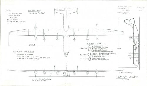

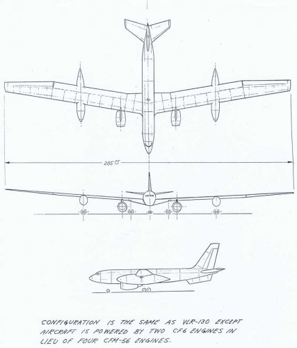

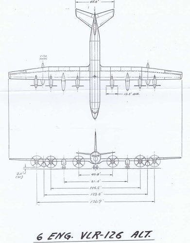

A couple more images for your viewing pleasure.
Vought Archive
bill

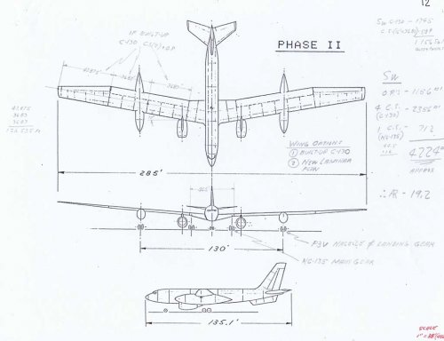

Fantastic projects! I love that sort of project which builds upon a proven airframe and attempts at optimizing it. The VLR C-135 PHase II is a thing of beauty! I can imagine these projects could lead to very nice what-if models.
