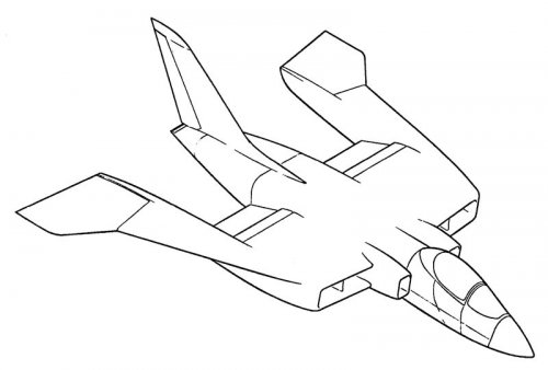

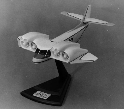

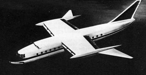

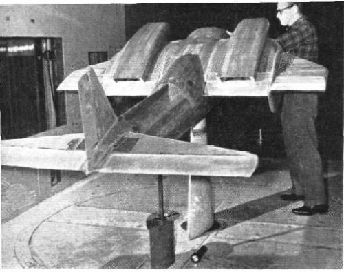

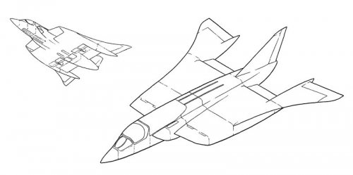

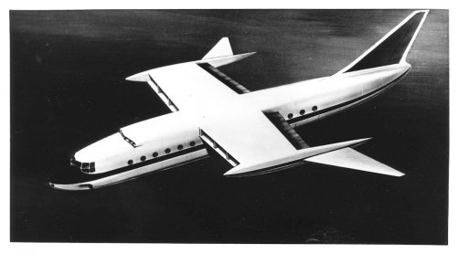

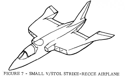

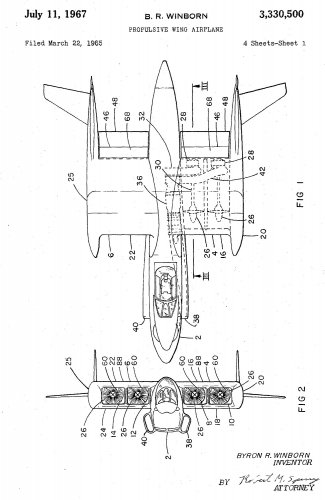

The two Vought-Adam VSTOL types should use a fan-in-wing concept.
Here are two pictures of them from Aviation Week 1968,19-26.

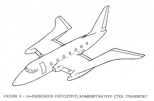

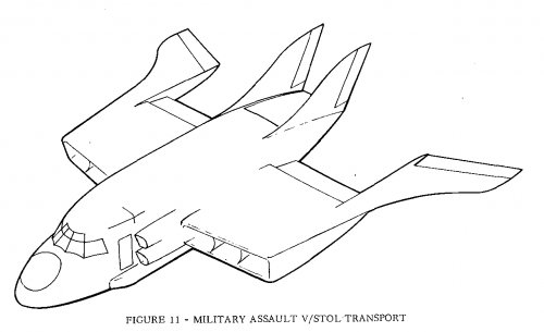

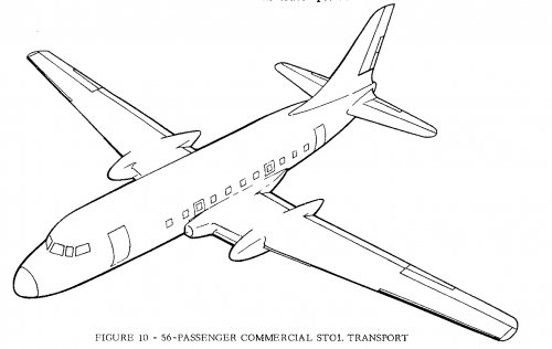

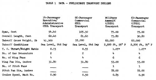

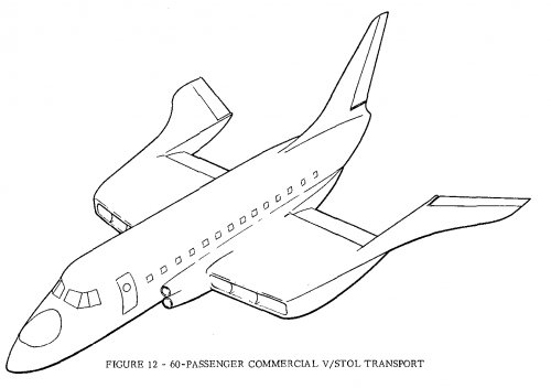

From
THE ADAM 111 V/STOL CONCEPT
by BYRON R. WINBORN, JR.
LTV Aerospace Corporation
Dallas, Texas

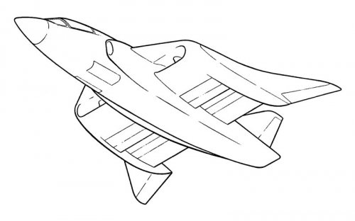

Greetings All -

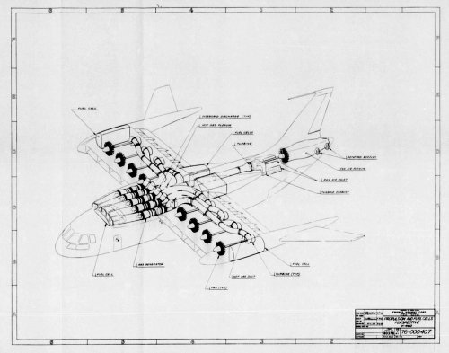

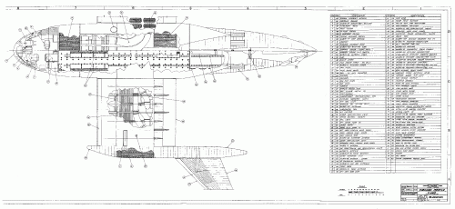

I'm new to the forum and this is one topic that is dear to my heart. I go down yearly to do volunteer work with the Vought Retiree's Club/Heritage Group and have spent some time in the proposals files. I'm planning on going back down this Fall and do some more hunting and research, particularly on the ADAM designs.

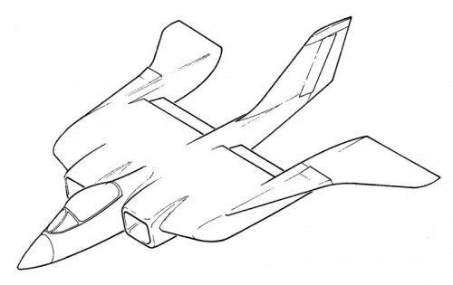

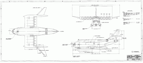

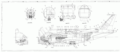

The following are scans of a set of drawings filed under "Advanced Concepts". Secoy appears to the be the designer or drafter for the drawings and the dates are noted in the file name when one was included on the drawing. The general description is mine save for the LAAS and HSV labels. I'll post more of these tomorrow.
Later 'll post some of the design proposals after I get back from a trip. These will cover the Vought proposals for what became the A-6, the E-2 and the F-14 as well as a few others.
Enjoy the Day! Mark

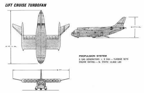

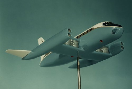

And another "variation on a theme", from Aviation Week 1968 19-26.
Was this concept ever tested in some form of hardware?

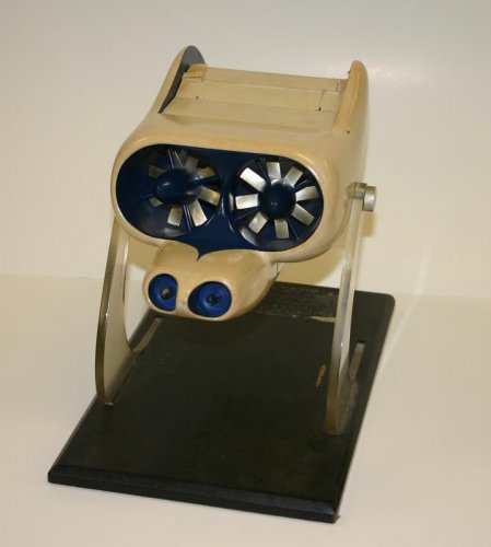

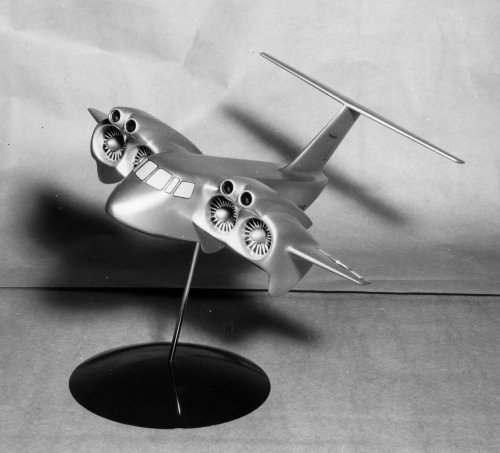

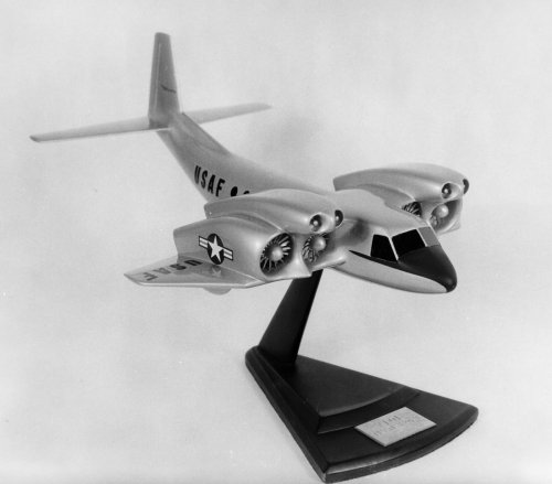

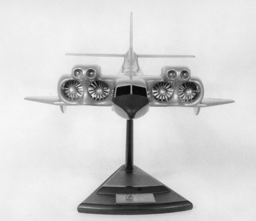

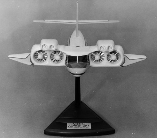

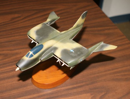

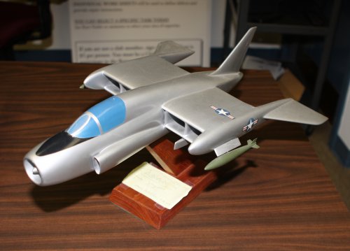

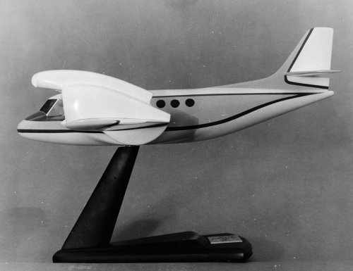

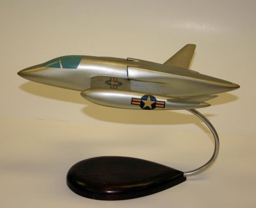

I need more than a day to go thru the files on my next trip to Vought :)

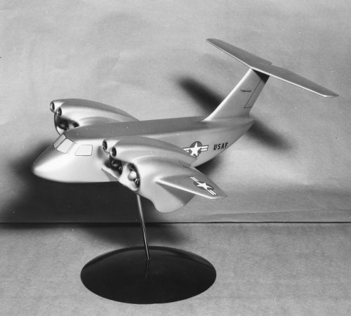

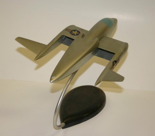

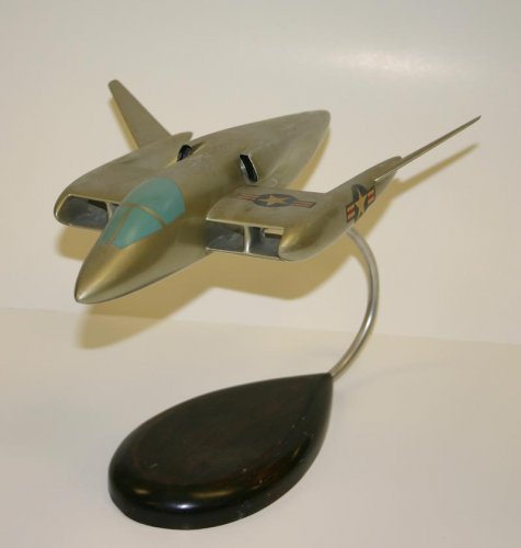

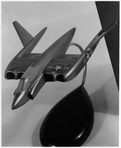

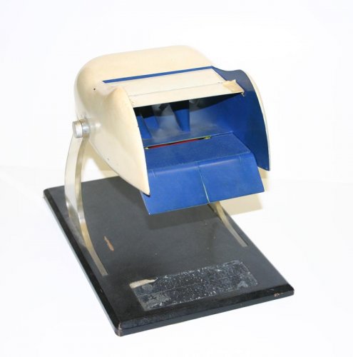

Here's a few pics I took of the display models and a bit of art in their collection.....
Enjoy the Day! Mark

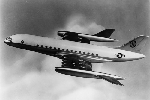

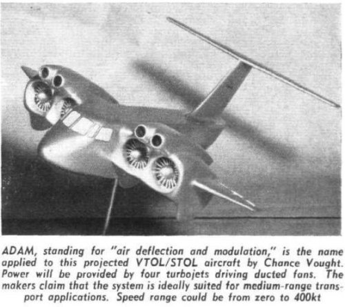

the Vought ADAM as medium range transport aircraft.
http://www.flightglobal.com/PDFArchive/View/1960/1960%20-%202413.html?search=grumman%20vtol%20project

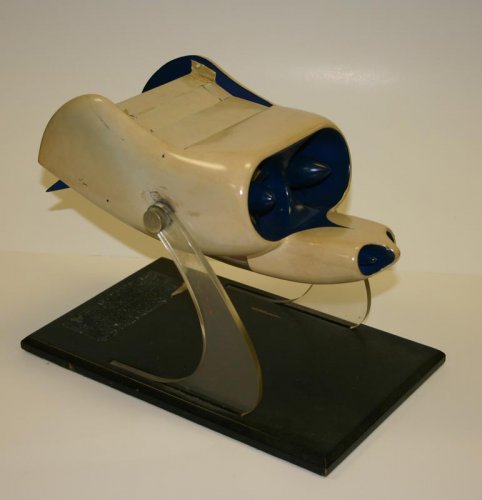

elider said:
ADAM pics from Vought Aircraft Heritage Foundation
I think this model for Vought ADAM II had only one tail fin
and different from elider model.
http://www.flightglobal.com/pdfarchive/view/1967/1967%20-%201899.html?search=all%20wing%20aircraft%20projects

I just have a question about Adam's VTOL bomber, as represented in the most recently posted color picture:
Umm...ahem...9 engines?!
Weren't Vought part of United Aircraft along with P&W? Might explain that :)

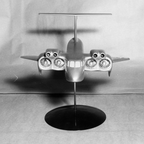

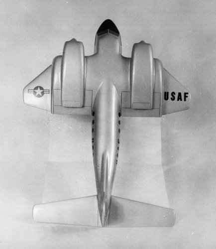

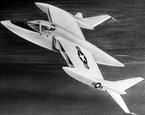

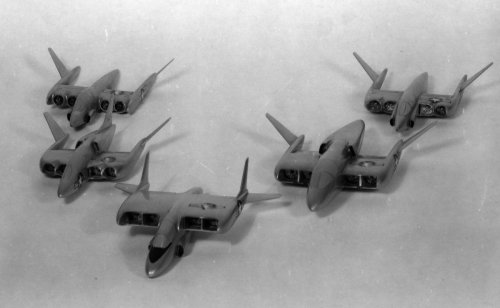

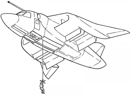

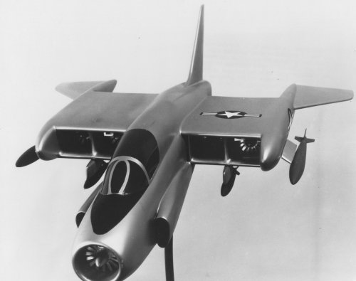

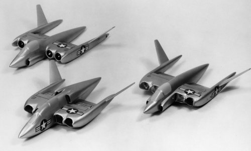

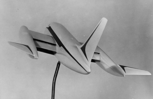

Okay, here we go with various ADAM models and drawings. I'll start out with the early iterations (the A phase based on the study paper) which had large horizontal stabilizers as an obvious design element.
Enjoy the Day! Mark

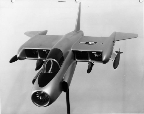

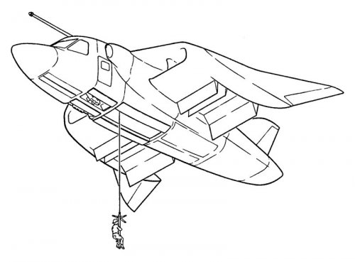

And a few more for your post Christmas viewing pleasure!
Enjoy the Day!

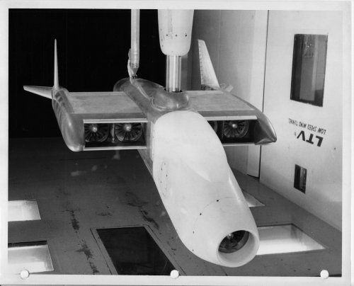

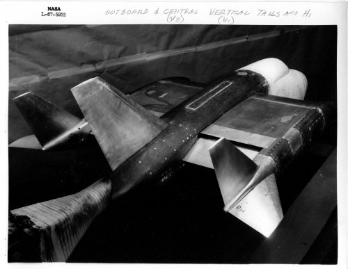

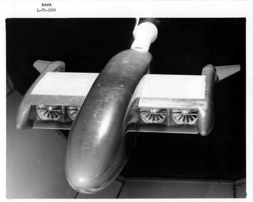

Windtunnel test reports of the ADAM II configuration.......
http://contrails.iit.edu/DigitalCollection/1968/AFFDLTR68-031part01.pdf
http://contrails.iit.edu/DigitalCollection/1968/AFFDLTR68-031part02.pdf
http://contrails.iit.edu/DigitalCollection/1968/AFFDLTR68-031part03.pdf
http://contrails.iit.edu/DigitalCollection/1968/AFFDLTR68-031part04.pdf
Thanks to Stargazer 2006 for link to the page I found them on.... ;)
