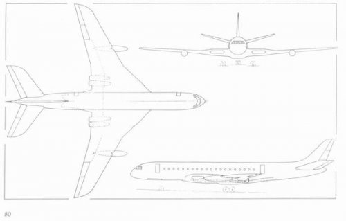

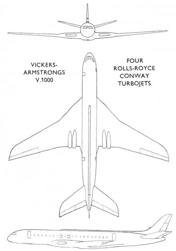

Attached a 3-view of the VC.7 (from D.Wood "Project Cancelled"). As is told inh this book,
one of the reasons for the failing of this project, laid in th fact, that the civil VC.7 was seen
as a derivative of the military transport, which was designed with several features not necessary
for a civil aircraft of this class, e.g. short field performance. Basic data given for the V.1000
are : 42,67m span, 303,5sqm wing area, 42,06m lenght and 3,81m fuselage diameter. After
several design changes weight had risen to 112.493kg, so an up-rating of the Conway engines
was necessary. And with the cancellation by the RAF the type finally was doomed, as there
wasn't seen enough export potential.

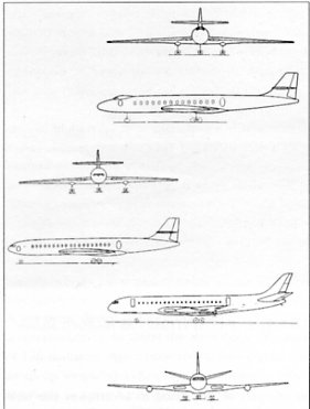

Archi you should also consider this book for Christmas: Stuck on the Drawing Board. Unbuilt British Commercial Aircraft Since 1945 by Richard Payne. Ed Tempus. ISBN 0 7524 3172 2.
It is a treasure!
V1000 was ordered in 1951 to replace the HP Hastings. It would give logistical assistance to the V-bomber force deployements anywhere in the World.
Contenders:
a) de Havilland stretched Comet
b) HP Victor double-bubble fuselage derivative
c) Avro Vulcan derivative
d) Short Sperrin derivative
e) Vickers Valiant derivative
f) Bristol Britannia forward variant
g) Saunders Roe Duchess forward variant
A commercial variant for BOAC was also envisaged, the VC7. It was proposed as a Comet II replacement.
The best proposals were Vickers and de Havilland and Vickers was declared winner. Production order was placed in 1954. The design was revised to compete for the Comet 3 replacement against the Avro Atlantic, Bristol 187 and HP 97 (Pacific). This forced the RAF to accept a bigger aircraft than originally accepted. By 1955, it was found that all-up weight had increased and BOAC began to cool towards the VC7 advocating for new Britannia and Comet developments while puting forward designs studies for new aircraft. The VC7 could have been in airline service by 1959-60.
The final came when the military order was cancelled and on 11, November 1955 the program was also cancelled. Vickers had been trying to interest BOAC with different engine options and design variants with underwing poded engine layout but BOAC ordered the 707 and British Airliner development lost its way.

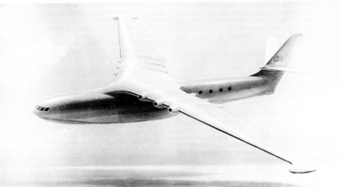

The Duchess was this beauty ::)
(From Sea to Air. The Heritage of Sam Saunders. By Tagg & Wheeler. ISBN 0-9509739-3-9.
A masterpiece! 316 pages full of unbuilt projects)
Britannia and Duchess were discarded early in the selection process.

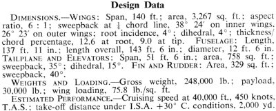

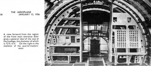

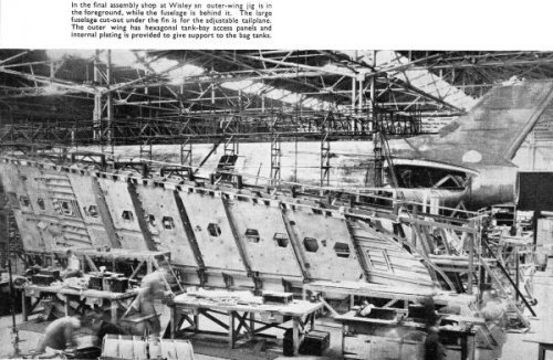

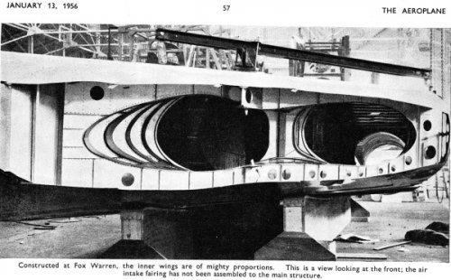

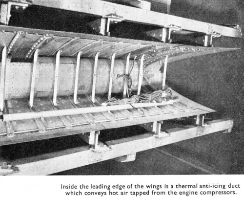

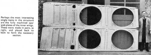

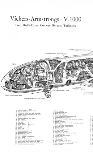

The Aeroplane 13 January 1956 pages 56 to 66 "The V1000.- A Structural Study"

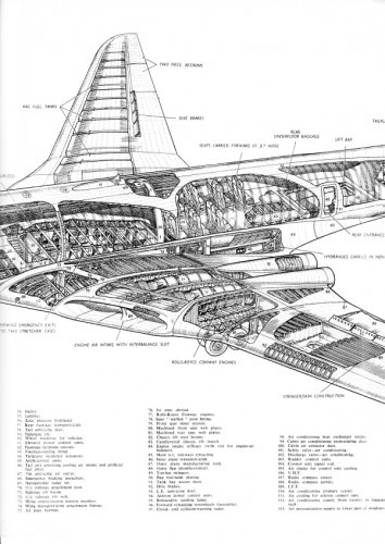

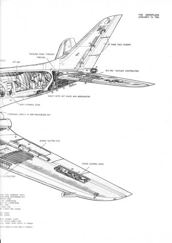

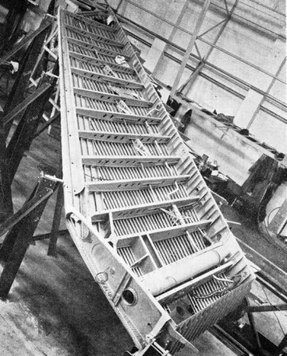

Barrington Bond
May 4, 2007
938
179

Hi;
The drawings have detail I have not noticed before, The end view much more civilised, does not show the four open urinals and the four stalls shown in other drawings for the "trooper version"
From notes taken some years ago.
Bill Gunston gives a possible figure of 286,000 lb. that fits the case for maximum fuel load with a payload of sixteen and half tons.
An extra one thousand yard allowance had already been allowed for but was not required only a mere few hundred feet at most. The large wing was very efficient with a very advanced section and far superior to that chosen for the Boeing 707/KC135 allowing a huge payload range growth potential with an exceptionally high ceiling for the class of aircraft. The ceiling was important in the case of the Military or planned RCM/Radio warfare variant.
“The position now reached with this aircraft raises doubts as to the wisdom of trying to develop a strategic jet transport aircraft, with a large range and payload and cruising at a high speed, but expected to operate safely from fighter airfields in tropical conditions.”
“Bearing in mind the inconsistency in the take-off requirement, it appears that some concessions in some parts of OR.315 will be necessary.”
“It is clear from the Air Council record that the lateness of the aircraft was not considered in itself to be unacceptable if other wise the operational requirement were met”
Failure to meet an early in service date was the main excuse given publicly for cancellation. Secretly it was pointed out in a Ministerial briefing document that the early in service date could have only been met by placing a production tooling contract to run concurrently with the prototype contract and this was not done. It also indicated/stated that Treasury procrastination with funding was also responsible for an additional delay of a year or more. It was always understood from quite early on in the programmes development that the late fifties in service date was the realistic proposition that would have allowed a developed engine with a power rating that would have allowed the aircraft to fully meet or comfortably exceed all the original operational requirements. This date was generally understood and accepted that it posed no significant problem to the end user.

Some great pics there Barrington Bond!!!
Now that looks like some seriously strong construction.
I wonder how difficult it was to destroy these parts, after the project was cancelled?
