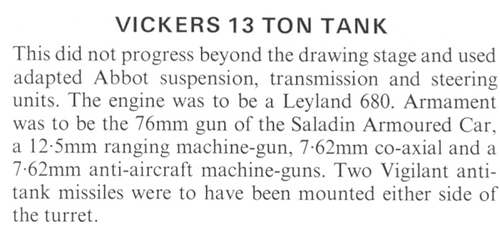

Wasn't there a proposal to fit a Saladin turret to the 433 or 432 chassis? Was the 433 roof cut down compared to the 432?
Here is a cut-out from "AFV Weapons Profile 51. Abbot FV433 Self-Propelled Gun" by Christopher F. Foss.
Piotr
I believe this morphed into scorpion, at a much lighter weight. A 433 with a 76mm is going to be a bit light on armament
, also would assume scorpion as better value for money.
Well, certainly with THAT 76mm. Maybe one more like the gun in the AMX-13 (and preferably the later 90mm version) would have made a lot more sense.
Piotr
The Vickers 13 ton tank proposal was discussed on another thread years ago. There is a recently published book on British armoured vehicles which may help on this and the question of Abbot as opposed to FV432 detivatives. Cant find my copy at the moment.

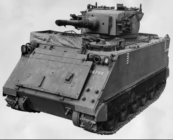

There was a Peak proposal for a much simpler Rarden mounting which was trialed on an M113 and would have been fitted like the Ferret turret on the Aden conversion shown elsewhere. It looked a bit like 20mm mount on a Marder but compacter. I am not sure where I saw it. I think it was in an old copy of Defense Review International from about 1970. Cant find it anywhere online.

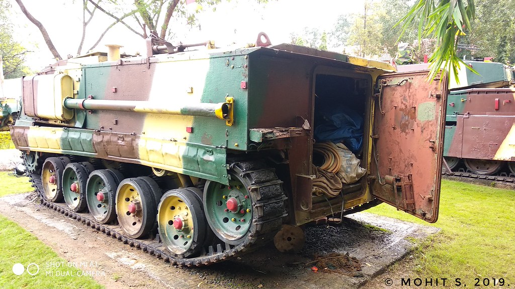

India acquired some FV432s when it had the Abbott guns.
Never seen a photo of one. Also wondered if they were planned to buy more.
This perhaps?
More: https://commons.wikimedia.org/wiki/Category:Vehicles_at_the_National_War_Memorial_Southern_Command
