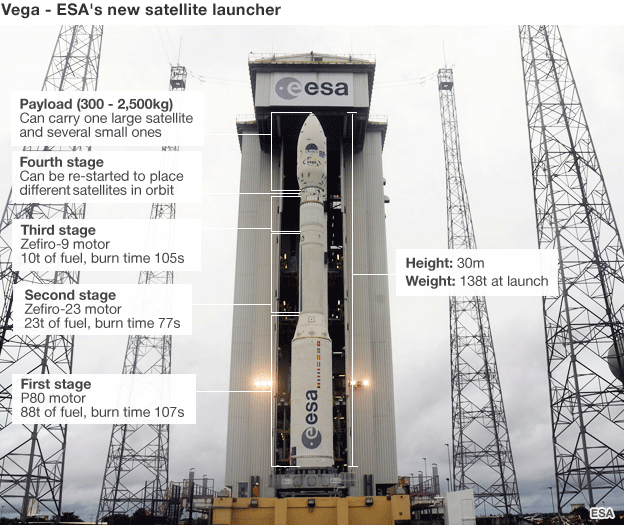

Re: Europe's Newest Rocket
IMAGE CREDIT: BBC News​

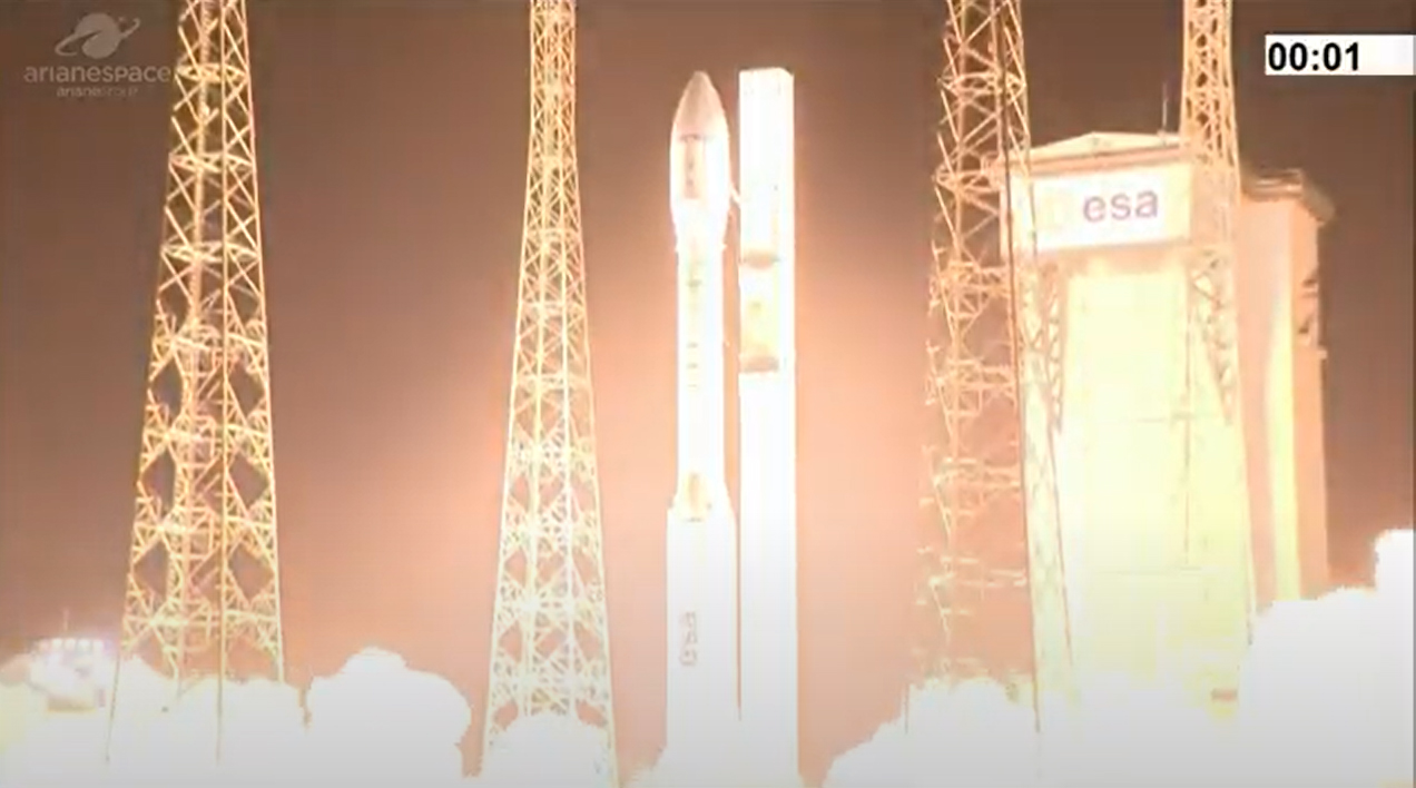

July 11, 2019
Flight VV15: Mission failure
Approximately two minutes after the Vega launcher’s liftoff from the Spaceport in French Guiana, a launcher anomaly occurred shortly after ignition of the Zefiro 23 second stage – leading to the premature end of the mission.
Data analyses are in progress to clarify the reasons for this failure.
An independent inquiry commission will be set up in the coming hours.

what Scott Manley Video show on Vega launch
Seems that Second stage not ignited

Indeed a very strange and unusual failure for a solid rocket booster.
