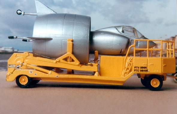

SNECMA C450 Coléoptère on Armor Aéronautique trailer as delivered to SNECMA 1/72 injection kit by Mach2
built article in French
http://modelstories.free.fr/analyses/avions/MS2002_10P/MACH_COLEO/index.html

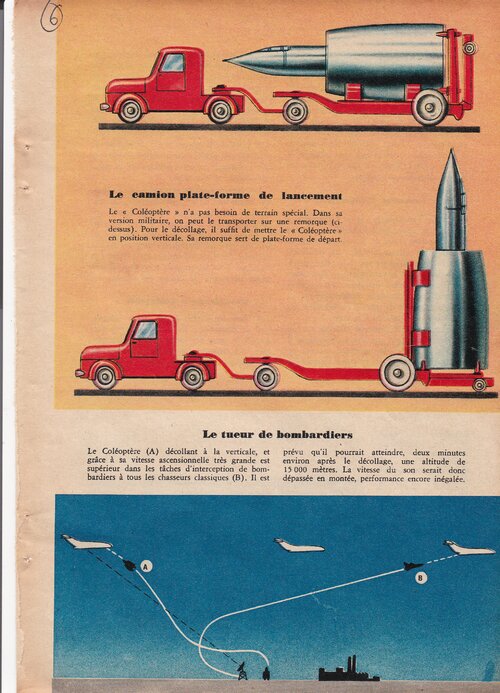

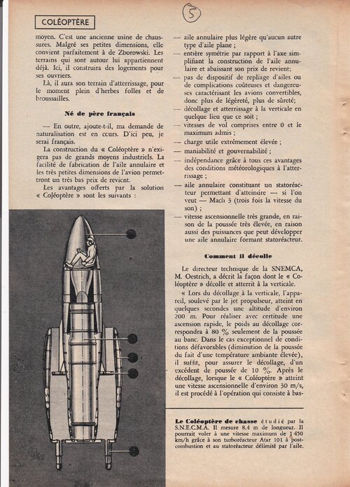

another article from Sciences et Vie Avril 1955, for you camarades !
