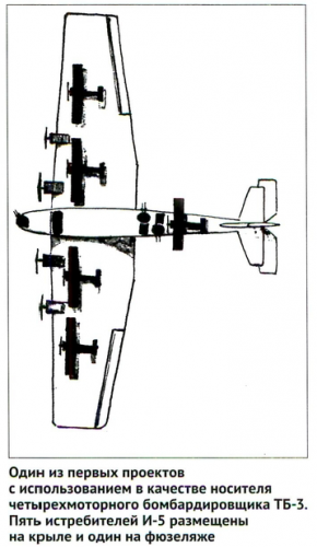

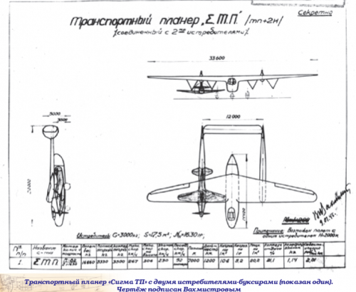

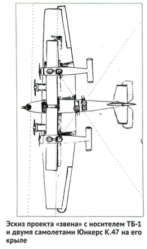

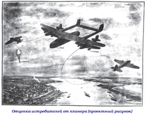

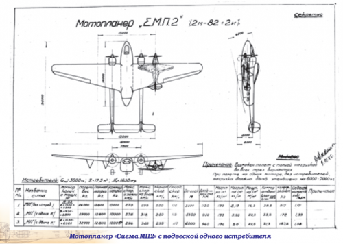

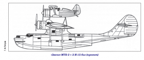

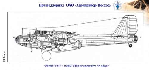

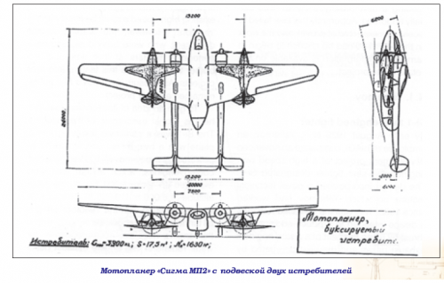

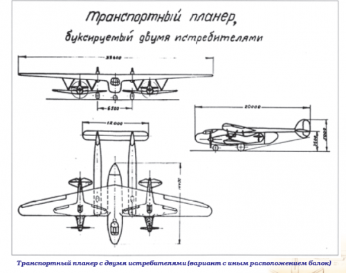

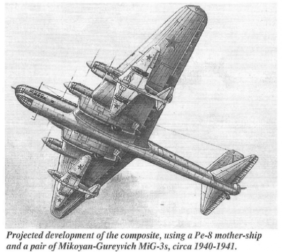

here is an unknown composite aircraft projects,for the Russian designer V.S. Vakhmistrov,first three was TB-7 with MiG-3,GST with I-15bis and MTB with
I-15bis,also he created a twin boom aircraft,used a composite aircraft,two of them was a gliders.
Kryl'ya Rodine 7/2014

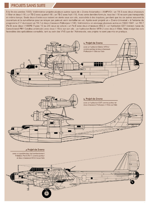

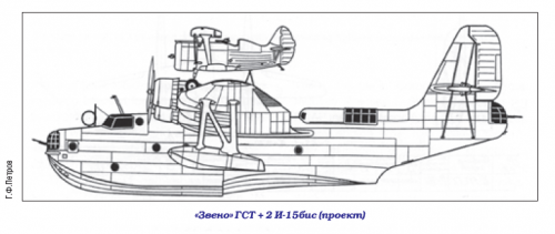

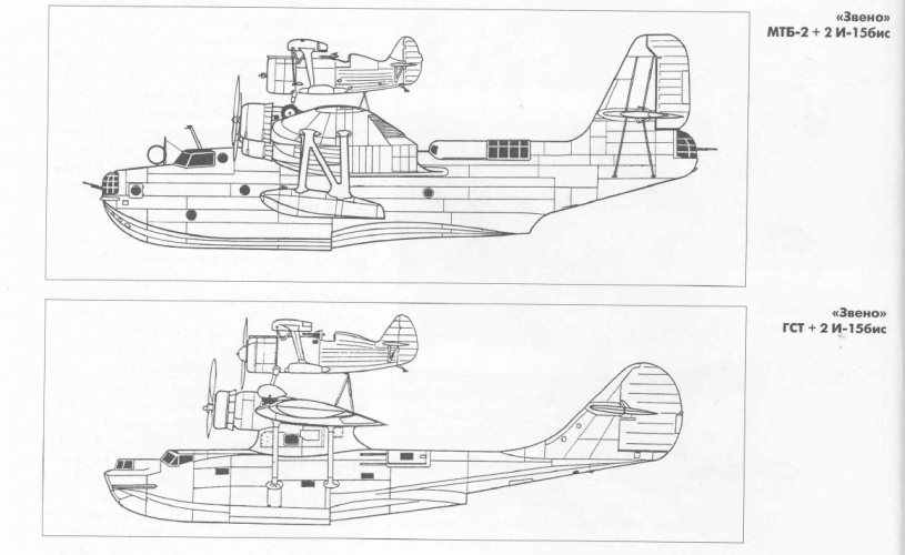

The images 2 and 3 seem to be mislabeled. "ГСТ" (GST) was the Soviet designation of license-built PBY-1, which appear on the other image labeled as "МТБ-2" (MTB-2 a.k.a Tupolev ANT-44).
Basically, the caption should be switched between the two images.
I think that's right.

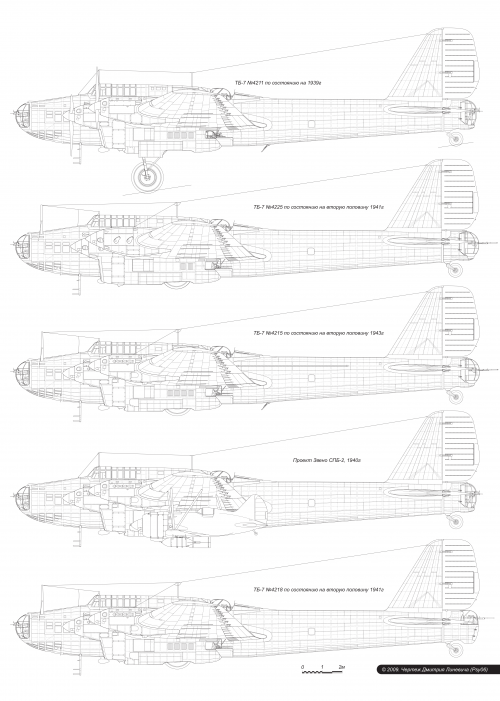

Hesham, do you have any more info on these three aircraft? Mainly the TB-7 and twin boom aircraft. I would like to know about them if you do. Thanks!
