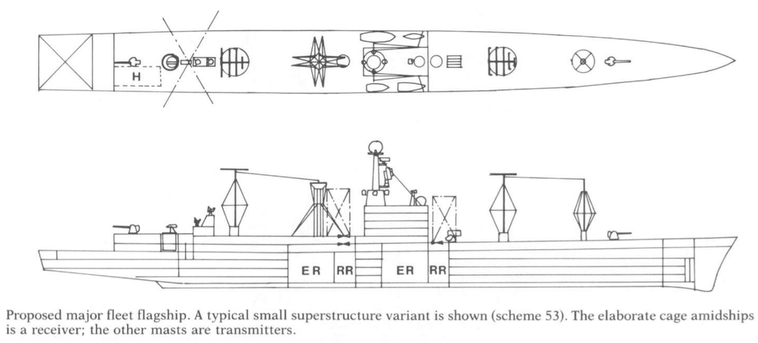

In 1966 the Long Range Objectives Group drew up a number of designs for fleet flagship. These ships were expected to have small superstructures, and flat decks with antenna farms similar to the converted light carriers Wright and Arlington.
However Opnav desired "ship schemes which are handsome and impressive in view of the intended mission of the ship. Such ships, with relatively large conventional cruiser superstructures, will have less than optimum communications performance and will be shorter and less impressive than the small superstructure flat deck.

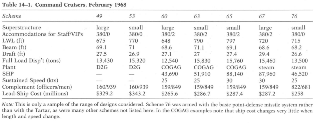

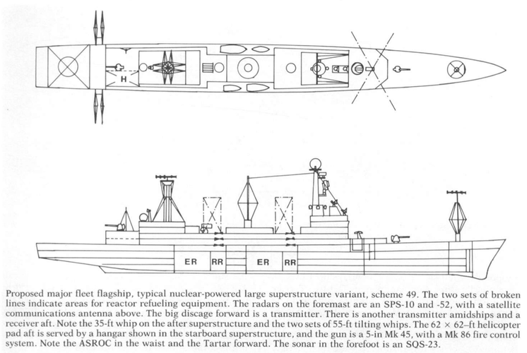

All ships were to have 2 lightweight 5"/54 guns, 2 twin Mk 32 torpedo tubes, ASROC, SQS-23 Sonar, protection against atomic blast and STOPS chemical warfare protection.(although this last point is immediately contradicted later in the text.)
A ship with the large superstructure, COGAG, BPDMS and without STOPS displaced 12,300 tons, and had a length of 626ft.
