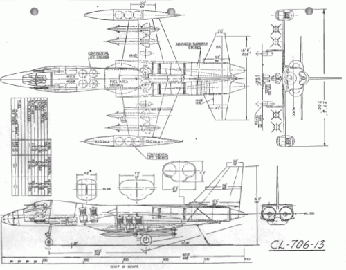

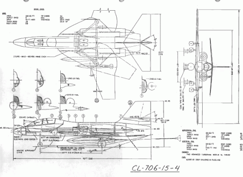

Been sitting on this info for some time, hoping something more emerged, to no avail. Early '60s projects are very little known. Anyway, here the state of the art regarding VAX (on my part, at least).
Lockheed was one of the original competitors. Lockheed California devoted the TDN CL-706 series to studies intended to suit the Navy VAX requirement for a substitute of the Skyhawk. The VAX program was reoriented at least two times between 1961 until its final demise in 1964, so the Cl-706 series contains very different concepts: subsonics and supersonics, CTOLs, STOLs, and VTOLs, one and two engines, fixed and viariable-sweep wing. Bill Slayton counted some 54 variations in the series. I post here two variations, the first with lift engines (evidently, VTOL, ot at least STOVL), the other probably STOL. It is not known which was the official Lockheed entry in the competion, but since the last iteration of the VAX specs were for a STOL vehicle with a sea-level speed on MACH 0.9 and a max speed at altitude of MACH 2.0 it was probably a VG machine. Additioanly, I can almost surely state that the Boeing entry, dubbed F-55.5 by humorous DOD personnel was Model 837-663, that indeed looked like a Boeing TFX scaled down (not really by half, though).
Now I hope that someone can add something... ;) Vought Heritage ? TT ? NAA, McAir and Douglas are (much) more difficult now. Anyone ?
Uh, maybe higher res of these will appear soon somewhere else...

Skybolt, those are VERY interesting drawings.
I see some curious features of the configurations:
-CL706-13: I can't tell at this resolution, but are those two 20mm cannons on the side of the cabin? i can only read 'guns' and '400 ammo'
-CL706-15's inlets are mounted above the wing glove in a position that makes me at least wonder about high-ish alpha inlet flow distortion. But i'm sure Lockheed would have had a good explanation for that
-The exhaust nozzles on both aircraft look like they have some very pronounced sort of 'sugar spoon' lip that extends out the back, kinda like some versions of the A-4 and U-2. Is that an aerodynamical gimmick to reduce drag or what?
These were supposed to be M2.0 capable aircraft, right? in that case wouldn't they have variable nozzles? Maybe i am interpreting the drawing in the wrong way.
Thanks for posting this stuff, I had never seen it before. Where did you find these gems, if i may ask?
Yep. In the -15-4 drawing the guns are indicated as being "Mk-12"s.
They were trying to keep the spot space at a minimum (the most succesfull CL-706 designs were less thn 50 feet long), keep GTOW down AND maximize internal fuel. Probably they didn't think the aircraft would have to do high angle-of-attack manouvers (note the Bullpup missiles...).
'sugar spoon'
No, it is a conical exhaust, probably a thrust reverser and variable geometry noozle.
The drawings come ultimately from the late Bill Slayton.

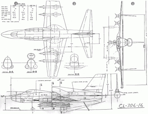

Another one from Lockheed. In this case it is quite obviously a subsonic STOL. Of notice the dorsal intake, feeding what seems a turbofan (TF-30 ?). All in all, could have competed as VAL had the derivative configuration from existing types not been mandatory.
BTW, in the CL-706-13, the lift engines are noted as "Continental": J-69 (Model 356), derivative from Marborè II ?

Skybolt, thanks for posting these gems. You mentioned that the design with the dorsal intake was STOL. Does the drawing mention what high-lift devices were employed?

BTW, from the Vought project number list it doesn't appear that the company tendered a design for VAX, except perhaps for a V-450 (light V/STOL attack aircarft), but I doubt. Or they tendered the various attack version of the Crusader ? The ones before the VAL V-463 ?

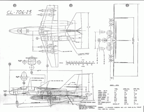

Another one, seems a variation of -16 with engines in pods. A subsonic STOL by all measures. Note the very large vertical and horizontal tails. CCV technology was pretty much in the future...

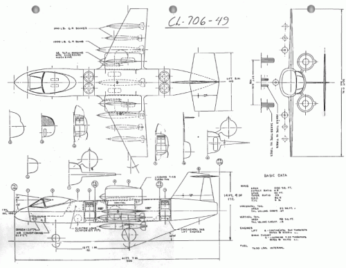

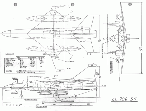

Two more. -49 was a subsonic V/STOL with apparently a side-by-side arrangement. Could have been more CAS oriented than other configurations (see main engine position). -54 is a rather baroque low-supersonic VG V/STOL with one TF-30 and 8 Continentals. Number of MK-81s carried is impressive. With these ends my reservoir of postable VAX designs. If someone else has something ....

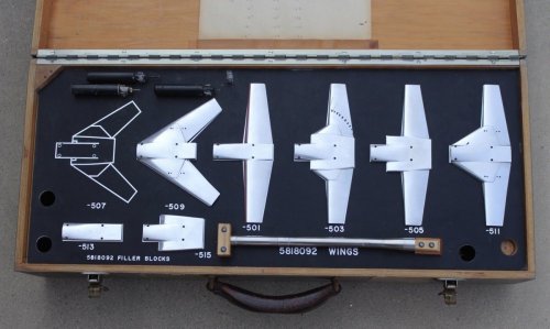

Here's what appears to be a very odd VAX design from 1962.

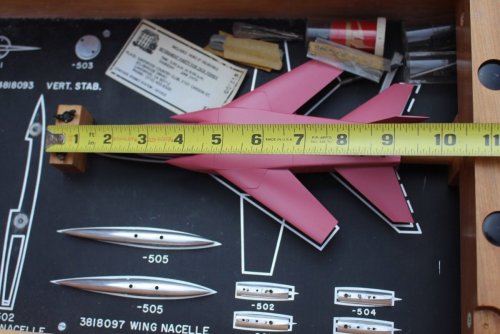

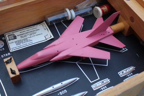

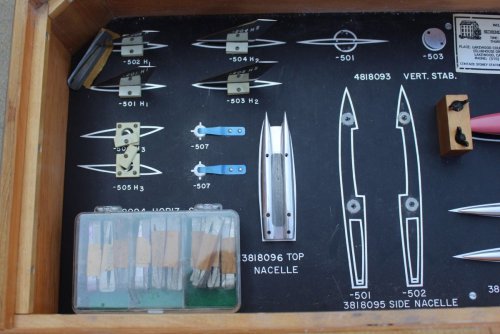

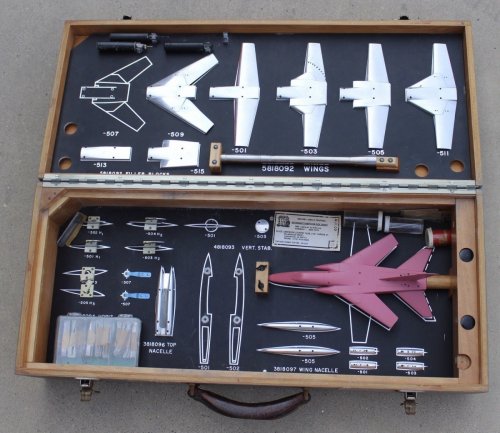

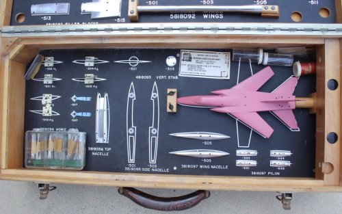

Great find my dear Scott,
and maybe it was alternative to Type-851 for early VAX competition ?.
I hope it ended up with circle-5!
Looks like a single seat Tornado...
Thanks! Mark
circle-5 said:
Sadly, no – I forgot to win the lottery that week. But I know who purchased it. It's in good hands.
You know, I had just such a memory failing. 2 of how many, darnit?

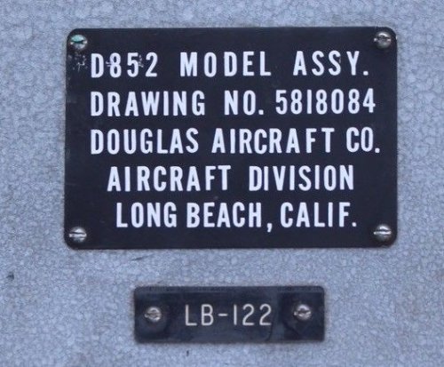

Does anyone know what the specifications for this design are, or this design studies mission?
On the assumption that the ticket in the box is contemporaneous to the model, does anyone know the Dick Ferris whose retirement is mentioned in the ticket inside the box? I doubt it was the Richard Ferris who ran United Airlines, since he came from the hospitality side of the business, not aviation.
"Thursday, June 24th" makes the party in 1965, 1971, 1976, or 1982 (much earlier or later than that seems unlikely).
It was a retirement party, so that may not help too much. But we do know that D-855 was their COIN contender in the LARA competition in 1964, so it really can't predate that by more than a year. TFX was long gone and Douglas hadn't competed - otherwise, you could think of -852 as being a post-F6D-cancellation study.
I wonder if it was a generic study of swing wings. But I second one observation above - the wing pivot and H-tail locations are very Tornado-like.
TFX would seem like the most likely project. McNamara had made this a dual USAF and US Navy project so the contenders were expected to team with a contractor who could build a navy version or were able to do so themselves.
Lockheed , Boeing and North American were single bids, Republic teamed with Chance Vought, General Dynamics joined with Grumman while McDonnell teamed with Douglas on the TFX, even though McAir were well experienced in building for both services. Thus the model is most likely the Douglas version of TFX for the navy.
The later navy TFX replacement, the VFX had a bid by the now merged McDonnell-Douglas, in which their swing wing model 225 had twin tails
